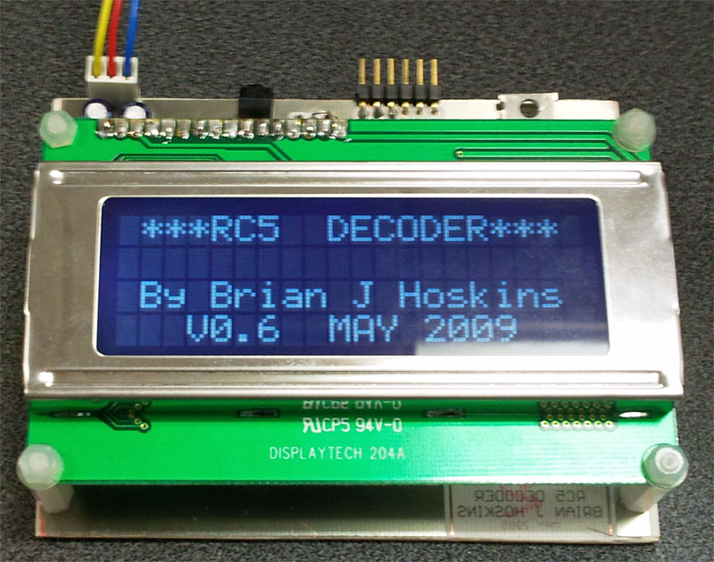

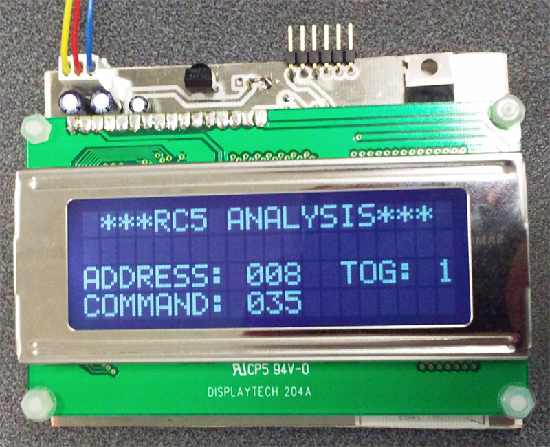

I wrote some code not so long ago that collects the address and command information from the RC5 data stream and stores it in "Command" and "Address" respectively. After that it applies some ascii correction to the data and splits the resulting ascii number into its hundreds, tens and unit components. It then prints the data out onto an LCD display.
Some of this code may be useful to you. You may not want all of it, or you may just want to use it as a basis for your own ideas. In any case I have attached it in this post for you to look at if you want. I have also attached some pictures that show the system working in practice.
The Toggle bit information is a bit buggy - sometimes it works and sometimes it doesn't. I haven't got around to figuring out what is wrong with it yet. But the address and command data is always accurate, so in that respect it is reliable. In your application, you would want to act upon the data rather than display it of course.
Hope it helps.
Brian
