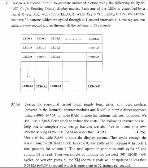

Question about LED animation
tonald
I have no idea about the question....
A 64 bit ram can just save the pattern of one column, how can it be read again to fill in the second columns and so on.....
Please click the attachment below to enlarge the photo.
Regards
First, I’m not at all sure what I read is possible. Therefore, I have to assume that there is another interpretation that instructor has in mind.
Given that the maximum allowed memory is less than the total number of bits in the 32 patterns, your greatest problem is going to be designing a compression algorithm that will hold all of the data in the permitted memory. Compared to that, the rest of the design is a breeze.
