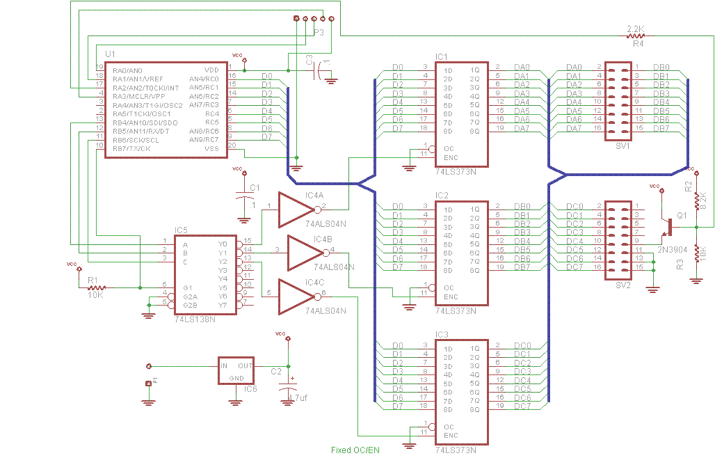

Here is how I expand the ports for more outputs:
