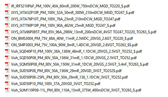

Spec,
As you recommend, I'm leaning towards using a gate driver regardless. I'll start going through the list you posted for the PMOSFETs.

If you want to use all N-MOSFETs, then you could likely use a high-side driver with a charge pump, such as one of those listed here to drive the top FETs.
I'm still trying to figure out if I can get away with using PMOSFETs for the high side. From the list Spec sent most of the PMOSFETs have a relatively high RDSON compared to their NMOSFET brothers, which at the currents I need would make them get a little too hot. I know there are heat sinks and other shenanigans I can try but finding a solution that simply doesn't dissipate too much power would be the best way. There is one from the list though (SMP3003) that may fit the bill. I'll keep your suggestion in mind though if I jump the PMOSFET ship and go back to NMOSFET town.
