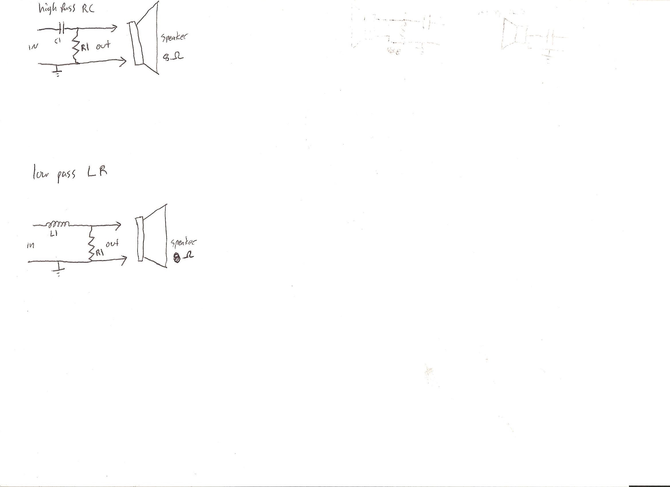

i have a question about RC highpass filter and LR lowpass filter. I attached a diagram. the top one is high pass RC. the bottom one is low pass LR. this is in reference to basic speaker crossover. My question is, can the 8 ohms of resistance of the speaker itself take the place of R1? or does the speaker go in parallel with the resistance of R1? thanks

You dont normally use a resistor in parallel with the speaker because it eats up power.
A series capacitor feeding a tweeter to ground is a very simple highpass filter with a gradual slope. Low frequencies are not attenuated much.
A Tweeter is fragile and can be destroyed by low frequencies from a simple filter.
A series inductor feeding a woofer to ground is a very simple lowpass filter with a gradual slope. High frequencies are not attenuated much.
A woofer sounds awful when producing high frequencies.
These simple filters are "first-order". An LC second-order filter has twice the attenuation of unwanted frequencies and a third-order filter is 3 times better.
