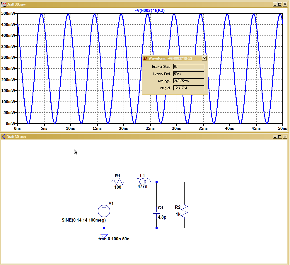

hello
When the plotter read voltage gain = +3.979 dB @ 100MHz for the L-impedance matching circuit shown
How much power from the source is on the R2 (the load resistance)?
thanks
hi sam.
This LTSpice simulation shows your values are very close.
Is this what you are asking for.??

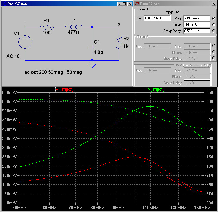

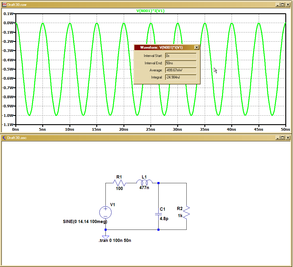

Alternate way of asking LTSpice the question. Green trace is power input to the network vs freq. Red trace is power in R2 vs frequency.
Note that Pin peaks at ~110MHz, while Po peaks at 100MHz.
