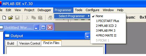

tama182 said:
am i right in thinking that this board, can be directly linked to you computer, and then you just program the chip through mplab, if so under whater programmer would you use in mplab,
http://www.velleman.be/ot/en/product/view/?id=350903
With none-MicroChip programmers (usually!) you save the assembled file to your hard drive, as a HEX file, then load that into your programmer software. This is basically what the MicroChip programmers do as well, but it's integrated seemlessly into MPLAB.
tama182 said:
when i save a hex such
lcd.hex
it ends up being
lcd.hex.asm
even if i save under all files
You don't 'save' it, you were just saving the assembler file - you need to assemble it, that creates the HEX file. I can't advise on how to do it with MPLAB, as I use MPASM directly.
ah got it, the hex file appears in the folder where you saved the assembler file, after you've built it,
