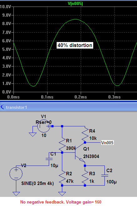

A single NPN transistor with a voltage signal input and a lot of AC gain is extremely distorted when its output tries to swing up to its positive supply voltage. So it will not be symmetrical like from an opamp.
Here is the simulation of a 2N3904 low distortion transistor with an AC voltage gain of 160 and biasing for a symmetrical output swing. Its output tries to swing up to +9.5V but can't and makes it up to only +8.5V instead with horrible distortion. Changing the biasing won't make much difference.

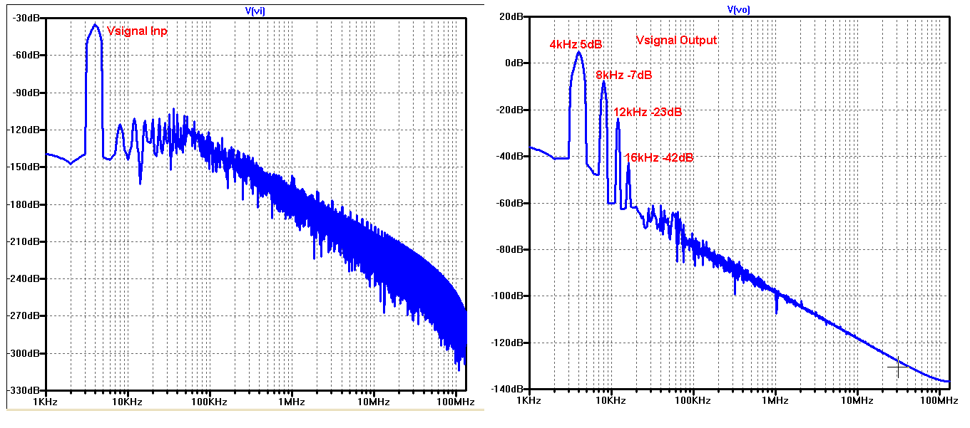

I can see the distortion and hear it on sine-waves. the top section of the sine-wave in my simulation is badly compressed because the transconductance of a transistor is not linear.
There is a way of seeing the harmonics of a sine-wave in LTspice but I have never done it. Yahoo has a users group.
I normally use opamps for audio. The opamps have distortion so low that you cannot see it nor hear it and almost not measure it.
Understand,thank Audioguru.
For reference, this is the FFT of 'agu's circuit , showing the harmonics in the output due to the distortion, using LTspice.
The transistor has a lot of even-harmonics just like a vacuum tube. If transistors are connected push-pull then most of the even harmonics cancel.
