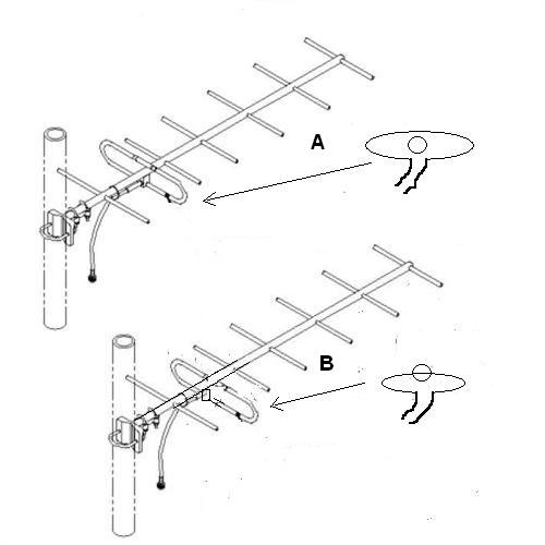

Is there any result differences (signal gain, etc..)between those two yagi fold dipole driven element position on the wooden boom (yagi A and yagi B in my images) ?
I would do a 2400 mhz yagi.
Thank

it shouldn't make any difference as that centre point on the folded dipole is electrically neutral
