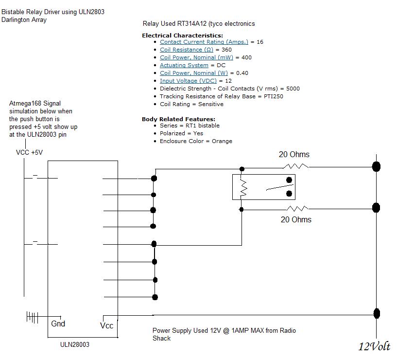

Ah it's latching opps. The resistors are the + path for each side of the coil, drop a resistor on your relay 4.7 to 47 may be fine. It's a really inefficient design as the 2803 will also have to drive current through the resistor too.

Would you mind telling me the logic behind using resistors to drive this Bistable relay and when we are connection both sides of the coil to +(positive) and when opening drain on either end lacting the relay.. I know its all about Current flow through the coil but I really want to know the Math behind it. I mean the calculations of resistor to acheive this HBridge sort of operation.
It's a kludge, the 2803 can only pull down to GND. You need a positive voltage on the other side of the relay and the 2803 can't do that so that's what the resistors are for.
The correct value will depend on the relays minimum pull in voltage. Try 47ohms first and see if the relay pulls in, if not decrease to 33ohms etc...

Driving Bistable relay using ULN28003 Trouble
Ok Boncuk and blueroom I made the symantic to show you my connections and as per Blueroom I reduced the resistors step by step to nearly 20 ohms and the relay would not respond. the Only way I made it to latch was directly applying power to it from the adaptor.
Boncuk I remeber you have solved this problem before , and I cant seem to remember which forum was it , this was the exact problem and you gave some suggestion which eventually solved the issue. Please look at the symatic and let me know what I am doing wrong . I have included all the related data in this JPG file. Thanks in advance
