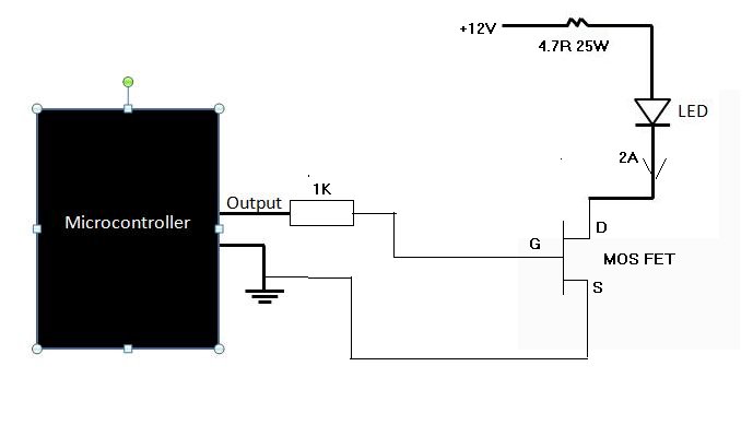

I am to design a circuit to light up a LED at the O/P of the microcontroller. What possible component can i add in the circuit to light up the 3V/2A LED.
Output voltage is 12V.
Sorry for stupid questions.
Urm what i meant was to adding components like resistor to complete the circuit but i do not understand what to add.
There is nothing to add, just connect the resistor to the output and the LED to Gnd.
Thanks mike but will the voltage damage the LED? Since the output of the MC is 12V and the voltage rating for the LED is 3V/2A.
A MOS FET like this type will drive a 2A diode, add a series resistor to the LED.
Note: a 200R with a 3V LED and a 12V supply will not drive a LED with 2Amps.
More like a 4.7R rated at least 25Watts!

Thanks for the info it helped me alot.

Do you mean we need another additional resistr?
Do we place the series resistor after or before the LED?

Look at this image.
Tuck3rz,
I will do my best to help you understand....
A MOSFET (metal oxide semiconductor field effect transistor), or any transistor can act like a switch.
Which is what it will be doing here in your circuit.
The "gate" (aka 'base') only requires a minute amount of current to effectively 'switch' the mosfet/transistor on. That is what the 1K resistor is for. To heavily limit current.
This is what your microcontroller will do. When you 'set' the ouput (logic 1), the MOSFET will turn on, allowing current to flow through the Drain to the Source (or if it were a transistor from the collector to the emmiter)
To put it simply,
- Output of Microcontroller goes high,
- MOSFET turns on (closes)
- Current flows from your 12v source through the big resistor, through the LED, through the MOSFET, to ground.
The low resistance resistor (4.7R @ 25W) is there to limit current seen as though the LED and MOSFET dont have much resistance...
It is only a small amount of resistance to allow a large amount of current to flow. That is why it needs to be rated at least 25W, becasue there will be alot of current passing through it.
Hope that makes it abit clearer....

Im not sure if the 4.7R resistor will limit to exactly 2A.
I dont know if ericgibbs worked it out, and neither did I.
Not sure if you need to work that out properly. The basic circuit is correct. But the values may need tweeking.
Use ohms Law to work out the right value resitor to limit to 2A.
V = I x R
I = V ÷ R
R = V ÷ I
P (in Watts) = I x V

Use ohms law to find current flowing.
I (current in Amps) = V (voltage in volts) ÷ Resistance (resistance in ohms)
so,
I = 12v ÷ .200Ω
= 60AMPS!!!
in other words, if you used a 200milliΩ, you would blow the **** out of your LED.
Yes, the lecturer should have changed the LED current to 20mA instead. It was an unrealistic circuit with a 2A LED and my guess was that it was a typo and should have read 20mA. He's now realised his mistake but chose to reduce the resistor to 200mΩ and you now have the worlds most powerful LED of 100W.
A normal circuit would drive an LED at 2V and 20mA via a 150Ω resistor from a 5V supply. I think what the lecturer intended was something similar but it somehow got confused.
