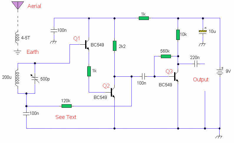

may be this would be of help
I found this while surfing....
This is a compact three transistor, regenerative receiver with fixed feedback. It is similar in principle to the ZN414 radio IC which is now replaced by the MK484. The design is simple and sensitivity and selectivity of the receiver are good.
All general purpose transistors should work in this circuit, I used three BC549 transistors in my prototype. The tuned circuit is designed for medium wave, but the circuit will work up to much higher frequencies if a different tuning coil and capacitor are used. I used a ferrite rod and tuning capacitor from an old radio which tuned from approximately 550 - 1600kHz. Q1 and Q2 form a compund transistor pair featuring high gain and very high input impedance. This is necessary so as not to unduly load the tank circuit. Q1 operates in emitter follower, Q2 common emitter, self stabilizing bias is via the 120k resistor and the tuning coil.
The 120k resistor provides regenerative feedback,between Q2 output and the tank circuit input and its value affects the overall performance of the whole circuit. Too much feedback and the circuit will become unstable producing a "howling sound". Insufficient feedback and the receiver becomes "deaf". If the circuit oscillates,then R1's value may be decreased; try 68k. If there is a lack of sensitivity, then try increasing R1 to around 150k. R1 could also be replaced by a fixed resisor say 33k and a preset resistor of 100k. This will give adjustment of sensitivity and selectivity of the receiver.
Transistor Q3 has a dual purpose; it performs demodulation of the RF carrier whilst at the same time, amplifying the audio signal. Audio level varies on the strength of the received station but I had typically 10-40 mV. This will directly drive high impedance headphones or can be fed into a suitable amplifier.
You didn't build this, did you? I remember commenting on this circuit not too long ago. I can't see how this is regenerative. I don't think the guy who designed it knows what he's talking about.
Please post the link where you found this.
Likewise, the only feedback is DC, decoupled with a 100nF, I'm also dubious about the supposed rectifying properties of Q3, with a 560 Kohm base resistor feed from the collector giving negative feedback.
That's trus, the 100nF capacitor will shunt all the RF to 0V.
The transistor might do some detection because it's non-linear and might distort the signal enough.
I think it was made on a breadboard and the sloppy wiring coupled the signal from the output back to the input in phase.
It got replaced by the MK484 which has plenty of other uses to simple AM radios.
