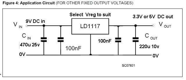

So I actually have two voltage regulators that I will be using to create a 5v and a 3.3v rail. Here is the application circuit from the 5v regulator:
The question I have is what type of capacitors to use? I have seen some people use two electrolytic caps, some use one electrolytic and one ceramic. The schematic seems to show ceramic caps, since I don't see polarity shown. What is the best combination to use to get fairly clean power?

The caps shown in the circuit, ie: Ci and Co can be unpolarised ceramic, general purpose types, rated at 25V or higher.
I would add a 470uF 25V electrolytic cap across Ci and a a 220uF 10V across Co.
Note: most electrolytics are polarised and are marked +/-/
For a simple linear regulator I would not worry about ESR..
NOTE: 9v 650mA ac adapter, with your circuit the adaptor must be DC out not AC

So a 470uF 25V electrolytic cap, and a 220uF 10V ceramic cap
Er, that's not what Eric suggested. He was suggesting a 220uF 10V electrolytic cap connected in parallel with ceramic cap Co.
Like this.

It's really VERY non-critical, I usually just use a couple of small electrolytics (1-10uF) depending what's on hand - they should be as close to the IC as possible.
As Eric has mentioned, the input side should also has a good sized electrolytic as well, as should any power supply.
