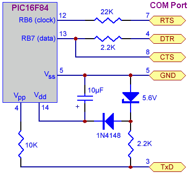

For a one PIC like 84A your NOPP LPT programmer is pointless to me.It cannot support to majority of PICS. If you like to build a good LPT programmer which supports to majority of PICS & giving less troubles better make this.
84A it’s an easy PIC to program. This serial programmer works well with 84A & some more PICS (not for all) & its supporting to plenty programming software’s too.
Il build the programmer then, can i input alot of lines of code into that program. i have a .bas file on my computer i would like to put on the pic.
If i build this circuit what software and compiler should i use?

I can vouch for the software that comes with the NOPPP. I built one of those programmers as a project in highschool and we used it to program a PIC16F84 with a Simon game (the game where you have to remember a pattern of beeps/lights that gets progressively harder).
But you will need a hex file to use with the programmer.
