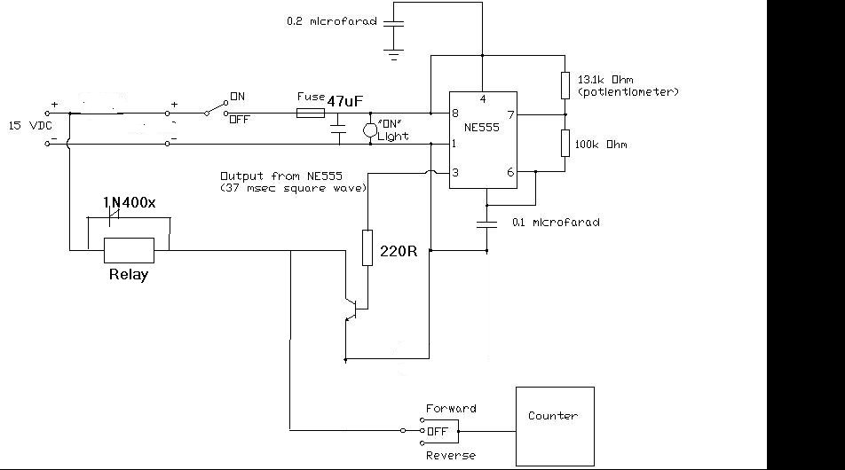

I have a circuit using the NE555 wired in the typical astable operation. I am using ~6.1V input (Vdd). However my ouptput square wave is measuring 3.2V. I need the ouput square wave to be at least 5V.
What is causing this and what can I do to correct this problem?
FWIW I also tried using ~12V input but I kept burning up chips. It seems to work fine with the lower volate but I am getting the unwanted voltage drop.
Thanks in advance.
You probably have the output overloaded. Post a schematic of your whole circuit.
Thanks. I only have a hand drawn one at the moment but will try to come up with something to post before I leave today.
See if this works. I did this quickly and please keep in mind that drawing electrical schematics are not part of my job so forgive me if I got a symbol wrong.
The switch is actually a double pole double throw switch but the second switch is practically independent with its own power supply. The output of the relay is also on that second schematic.
I'm not sure what information you may need on the counter/timer. If you have specific questions let me know and I can look it up for you. Thanks again.

The output of a NE555 (Fairchild Version) is rated at 100mA output at 5 volts, however at this output the voltage is down to 3.3 volts. Sounds like you have more than 100mA load on your output. The coil resistance of your relay need to be greater than ~100 ohms for a 5 volt relay.

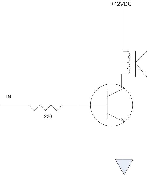

Thanks for the inputs Brown and Bailey. Just to clarify... I need to put in a transistor between the output of the NE555 and the relay?
Something like this could get you started, assuming that the relay is small

The TTL version is rated to 200mA, the CMOS version is rated to 100mA and that depends on the supply voltage.

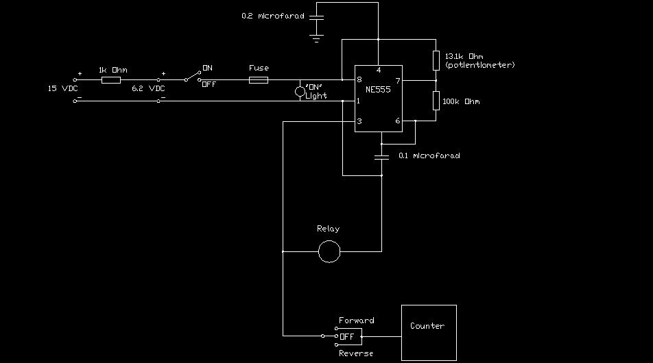

The NE555 I have is (don't laugh) a radio shack brand chip (TLC555 Timer). High output current capacity Sink: 100 mA (typ) and Source: 10mA (Typ).

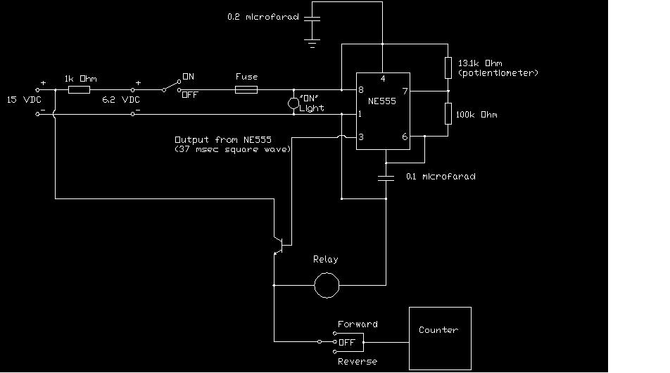

So this is what I purchased today- two NPN Silicon Transistor: one with an Ic of 3A and the other with 10A.
Please advise which transistor would be best and also please take a look at my updated schematic to see if this *Should* work. TIA.

I did't realize you were using a SS relay. Accordig to the data sheet, the input resistrance should be 1500 ohms, minimum. You're timer should be capable of driving that directly, unless I'm missing something.
Try disconnecting the relay and measuring the output of the timer. Maybe something else is going on.
OK. I will try disconnecting the relay, measuring the output.
Then connect doing the same with the timer. I will hold off on the transistor for now and report back.
Your circuit will not work as expected also the freq of the 555 is 75Hz, the relay will buzz.!
Can you please elaborate on this? I am not sure I am understanding?
THis modified drawing was assuming a standard relay, but as 'brownout' states with that SSR it could be a direct drive from the 555 to the SSR.
I'll post the drawing for ref only.
The time constants 13K/100K and 100nF give an output freq from the 555 at 75Hz
