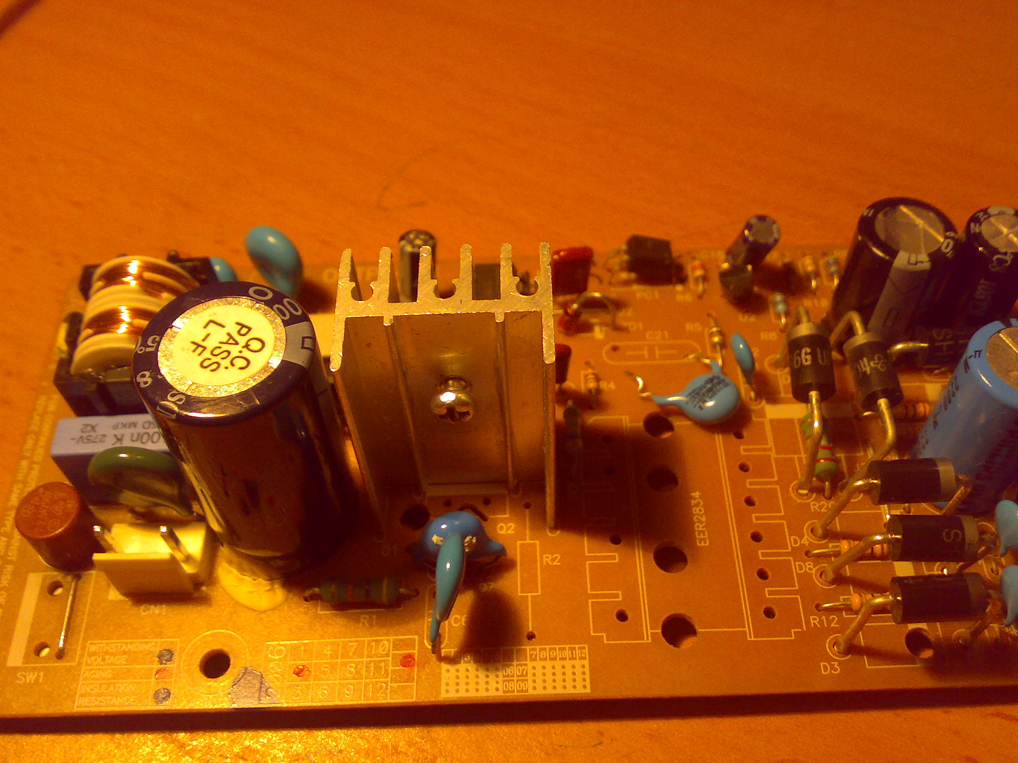

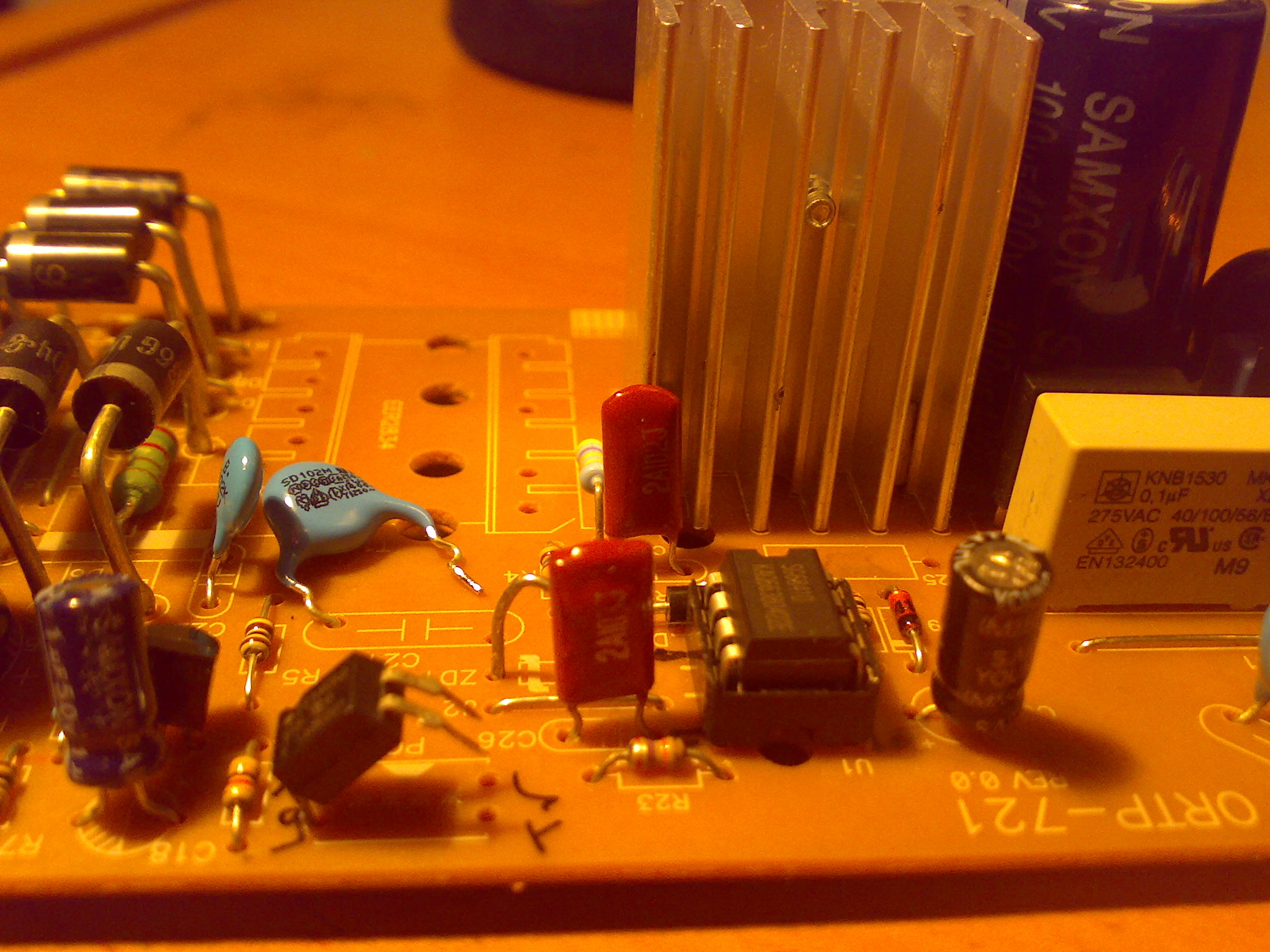

I have a smps belong to satellite receiver. It wasnt working. SG6841 was defective. i chanced it. After chanced i heared tic tic sounds from smps. I chanced main filter capasitor that is 100mf/400V. Again same. I controled mosfet SPA04N60C3 (Q2) its ok looking and i chanced anyway with same volts n-channel mosfet again same. Later i chanced at primer and seconder side all capasitors, resistors, diods, varistors and zeners. Again same. Later i desolder smps transformer at primer side 100mf/400v capasitor,opto-cuplor and mosfet. I controled gate enterance of mosfet between sg6841 pin-8 again i can see triggering. I chanced again SG6841 with new one. Again same.!!! :mad::mad::mad:
So what can be the problem?
I am sending last photo after desolder transformer,optocoupler and mosfet.
Note: only i didnt chance 220 filter transformer.

Thanks nigel. But you are seeing no transformer no mosfet. and filter capasitors also chanced( also elektrolitic capasitor).:confused:
Shorted secondary is common cause.
OutToLunch asked an optimal question. When it's plugged in do you have stable regulated
secondary side voltages.
no out. To pin3 must come min 250 volts. I disconnected 1M resistor. I am seeing 240 volts. Later i am soldering going to 16volts and triggering.

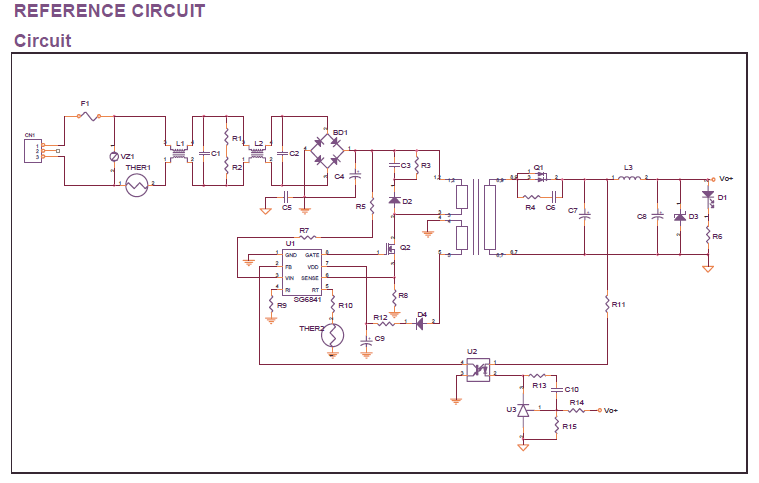

A ref circuit from the datasheet is attached here. the OP may comment whether the board is approximately following this schematic? I suggest that if the TL431 device is used, better change it and then test, with all other components restored.

Thanks i have datasheet of sg6841. I compared with application scheme, notes and test notes. To pin3 (Vin) driving via 1Mohm + 470kohm resistor. At scheme driving with two 750kohm resistors. So no problem with mine. And when i connect to vin 240 volts dieing. And no out from Sg6841 . SG6841 cant be defective because 3 times i chanced again same. Look to photos. No transformer, No optocoupler, no varistors and no mosfet. So there arent any connections with the seconder side. But Sg6841 working like heart beats.

It won't work without those components, it's powered from the transformer so can't run without it.

Guys today i checked smps on load its working !!! haa haa incradible When its working no load mode. Smps ticking. I pluged the smps cable to the pcb main board, Smps started to work. So ic was broken . I chanced but the tl431, mosfets, sckotty diods, resistors and all others were ok. Can u imagine. This smps working only on load.
Most do, it would be unusual to find one that works with no load.
