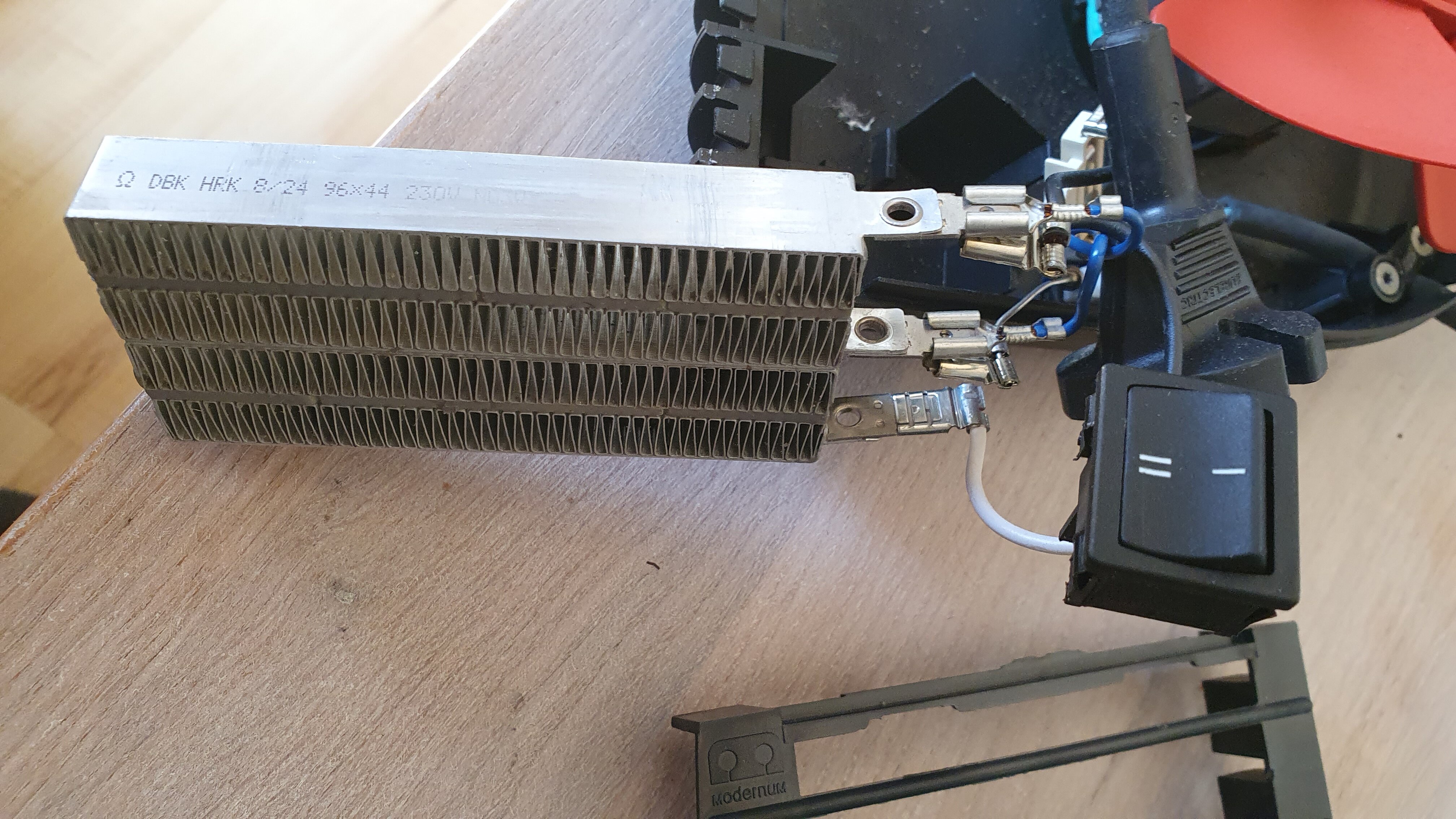

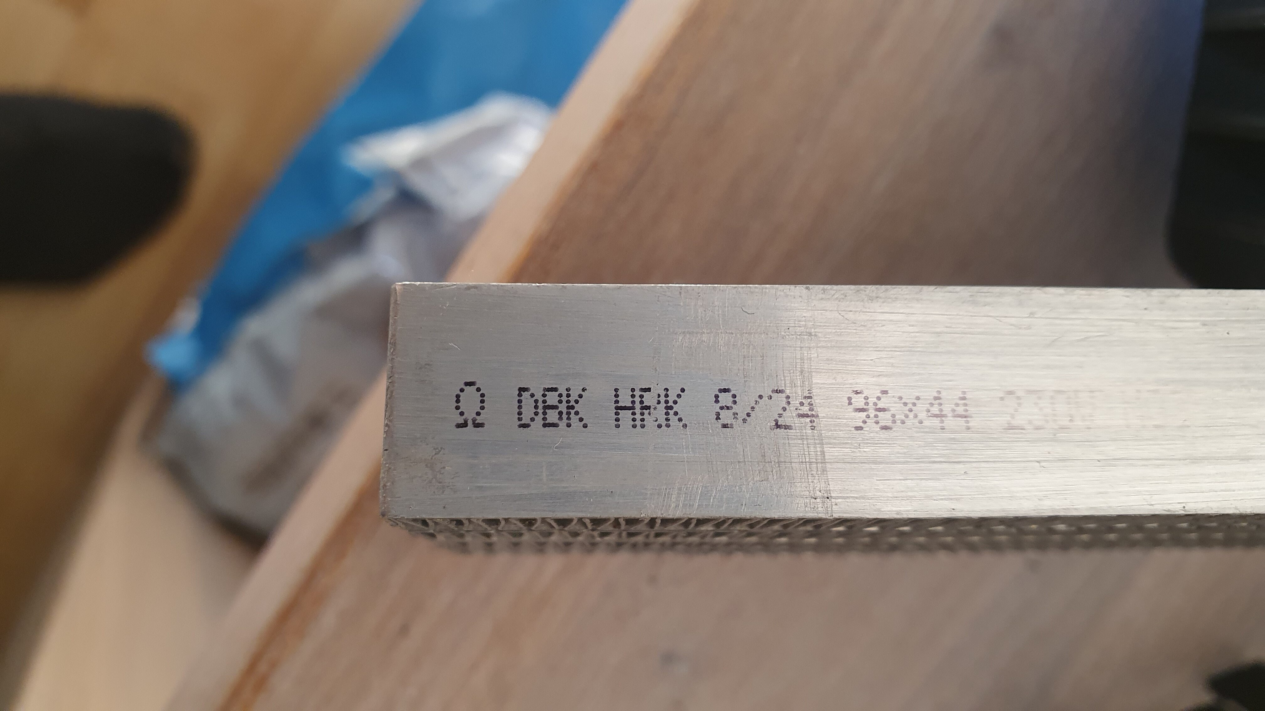

Hi there guys.
I have a old DEFA carheater, and im wondering if rhe heating element can be submersed in water? I have included pictures.
I wouldn't! It says it works on 230V and has no insulation on the resistance strips so it would make whatever it's immersed, in *live*, and if your lucky just blow a fuse or breaker. It is an air over type heater, putting it in water would be like a scene in a murder movie where they put a toaster in the bath tub.
Thanks for the reply mate. Thats what i guessed aswell hehe. Trying to make a diy waterheater, best solution ive found atm is a heater from a watertank
