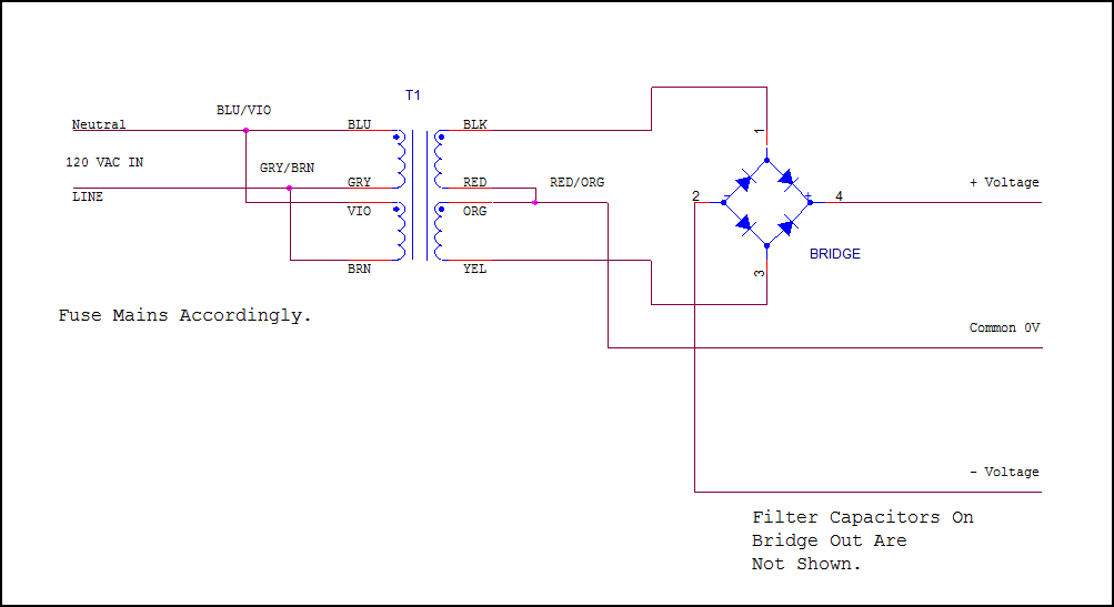

Absolutely, just be mindful of the phasing on the primary side as well as the secondary side. Use the left side of the top diagram for the primary and the right side of the middle diagram for the secondary.
You can connect the primary in parallel (watch the phase) and the secondary in series.
When you say "+40v, 0v and -40V" I hope the +,- are phase and not DC.
Thanks! I just wanted to double-check before I go making connections to this 500VA transformer! Needless to say, it will be fused.
To get ±40Vdc out, connect the output in series as you proposed. Ground the center tap and connect the two windings to a bridge rectifier. One output of the bridge will then be a full-wave rectified plus 40V and the other output will be a full-wave rectified minus 40V. (With a filter the actual unloaded outputs will be close to the peak voltage of 56V, of course)

If you have not yet wired it, the circuit would be wired like the attached based on the link to the transformer. The color code scheme for the transformer is taken from the link. The mains fuse is not shown. The bridge rectifier chosen should be chosen to handle the load and the filter caps also are not shown but I am sure you get the idea.

I'm using the 500VA transformer I mentioned to drive some power mosfets. However, I need a way to power some opamps and other circuitry whose supply voltage is around +-15v. I've been able to find both linear and switching regulators that can work at supply voltages as high as 60v, but there's been no luck on the regulation of the negative side.
I think it would be easier to just purchase a small 30V center tapped transformer that, after rectification and filtering, would give me about +-20VDC. Obviously, I would send the center tap of the transformer to ground. Would it be OK to connect the center tap of this second transformer to the "0v" (Common 0V connection in Relaodron's drawing) output of my 500VA transformer?
Yes. You need to do that to create +20 and -20v. Otherwise the +20 0v -20v will be floating and you will be able to "push" and "pull" the other circuit to get it working.
Yes, you can connect the center taps together. You can buy a nice board from Jameco which has the regulators and caps on it.
