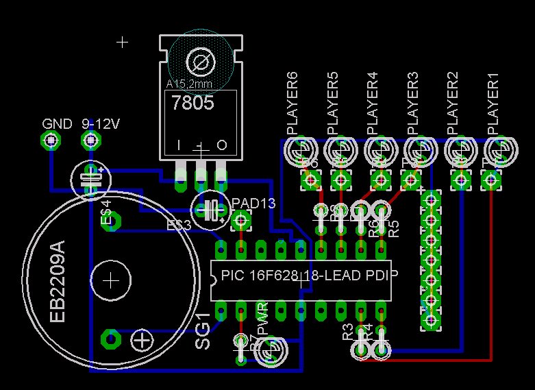

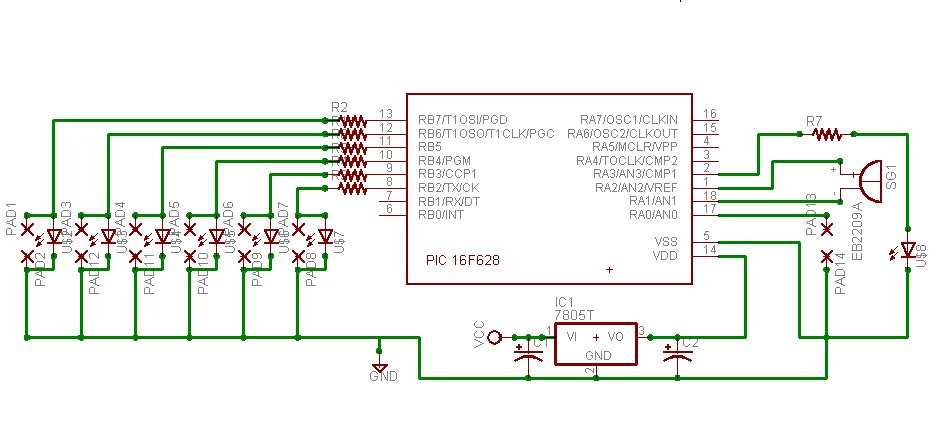

I quick (rough) microcontroller version using a PIC 16F628. I will etch the board tomorrow after I check it and whip up the code if I get time (tring to teach my middle son to write code in MikroBASIC for the PICS, and I know our family will play with this :) ). I made this for me, so LED will work, and I left PADS to solder my momentary buttons too. The one
with no LED is the quiz master.
I have a ton of "honey DOs" for tomorrow but I will try. And I have a help manual to write for a Win32 program I am doing with a friend in Washington. And he is riding me to get it done. Hope he never finds electro-tech-online or I will be in trouble. And he is an EE for Honeywell. :eek: So it could happen.
Anyway, here is a peek.
(NOTE: Not to Jace33, but other before you get on me (like the A missing on the uC, the buzzer, etc). I use two layers to speed up ratsnesting (and I need all the help there I can get). The red and blue layers, if see PURPLE I fix it.
When I print it on the laser, the red and blue are black (single layer). Also I stuffed whatever parts that were the right size so I can get the board etched and go play).

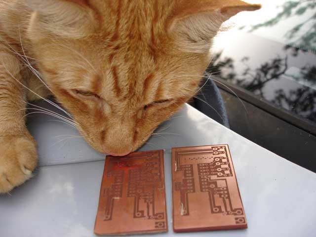

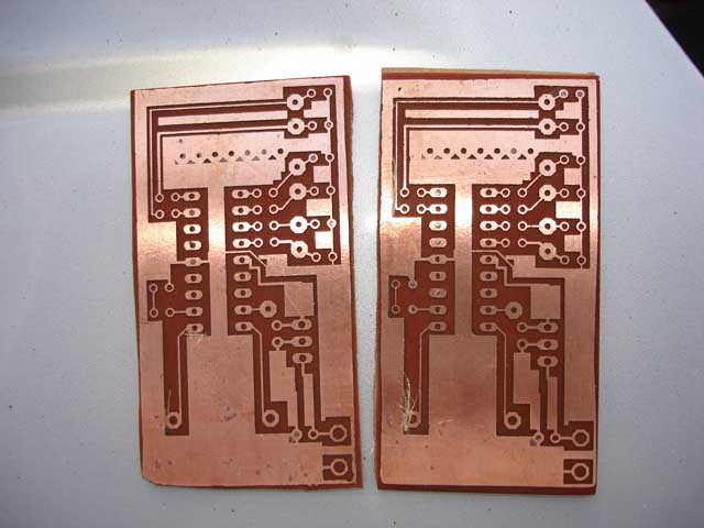

Well it was a long day, but I did get to etching.. Cat jumped up to check them out.
Will try to drill and do code tomorrow, but no promises (I would bet maybe drilled).. I never got my main projects done today so I still have to get them done (it is 11PM Sat here in the US so today is done)..
Also, mine is LEDs to showed who pushed the button first (for my kids), not what you wanted so you will have to work from this. The rest it probably the same as what you need.
