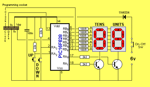

Hi everyone,
I've got a project which i have build but seem to have a problems on the second part. For the first part i have designed and assembled a circuit so that which 3 Player push buttons PB is depressed first, that button turns On its respective LED and disables the other two LED's, i didn't have any problems with that.
For the second part of the circuit,the player that turned its respective LED On, should be able to have the count on the 7-segment LED changed by one, by simply depressing the Right Answer Counter Up (PB) or wrong Answer Counter Down (PB).I have a problem with this part i don't know how im going to build it please any advices.By the way i am using electronic work bench v5.12 to help me build this circuit thanks

ok ok ok ok! i might as well just say it.I'm a beginner in this course i"m studying and i do need urgent help i thought i know the stuff but really i don't,so all i'm asking if you can get the circuit for me please
How does the circuit know which is the right answer and which is the wrong answer? How will it know whether to count up, or count down?

Do you want to count to 9?
Do you want three circuits - each circuit with the capability to count to 9 and also a count-down feature?
It would be wonderful if you could give a clear description of what you are wanting.
If you don't want three circuits, do you want two and a half circuits?
The player that turned its respective LED On, should be able to have the count on the 7-segment LED changed by one, by simply depressing the Right Answer Counter Up (PB) or wrong Answer Counter Down (PB).Also i need a reset button.And when i do say want it all in 1 circuit i mean that all the three 7segments are working on 1 borad, By the way i am using electronic work bench v5.12
Its more like a TV game show but without using a buzzer
It is still not clear, what you want, from your description.
I know exactly waht you want but you certainly have not expressed it in a definitive manner.
Here is a circuit of a 2-digit up/down counter.
All you have to do is add another 7 segment display and three buttons for the 3 players, plus a reset. The appropriate 7-segment display flashes when the first player pushes his button.
