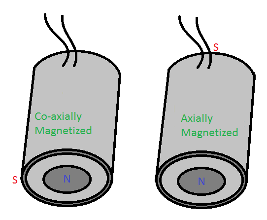

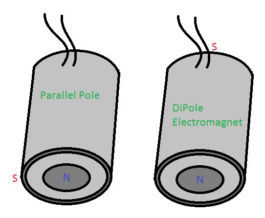

I may be missing something obvious, but are dipole electromagnets always far weaker than parallel pole magnets(not sure if that's the proper term)? I have noticed that the average 6 watt parallel pole electromagnet will generate around 100-125lbs of holding force, or power (my observation comes sales charts for electromagnets). Now a similar sized dipole electromagnet running on 6 watts seems to be lucky if it can hold 10 pounds.
It doesn't seem to make much sense to me that just because your making use of both poles, the power of the electromagnet jumps by an order of magnitude. Around 10X here. Any thoughts?

Not all magnets are dipole. And the the electromagnets in the pdf are magnetized like my drawing, the parallel one. In a cylinder electromagnet, dipole means one pole per flat face. The ones in the pdf have two poles per flat face. It makes them super strong. I was wondering why.

Yes well I can assure you these magnets are not axially polarized. They have 2 poles on both flat faces. North and South. I did not make up the term dipole, it was given to me by an electromagnet company who sent me an email for "Dipole electromagnets, which they described as one pole on either flat face. What your arguing is irrelevant, and half wrong at best. I have yet to find an axially polarized electromagnet using 6 watts with over 100lbs of power. I dare you to try.
i looked closer at the drawing in the first post., and the proper terms are coaxial magnet and axial magnet. the coaxial magnet is similar to a horseshoe magnet because the S pole is looped around and brought in close proximity to the N pole of the magnet. in simple terms the magnetic lines of force are concentrated in the small circular gap between N and S. the axial magnet has the same lines of force, but they are spread out over and around the whole body of the electromagnet, and so don't provide the same amount of holding force.
Alright, thanks for the terminology. I'm just curious as to how they actually wire it. So horseshoe magnets generally speaking are stronger because they make use of both poles.
