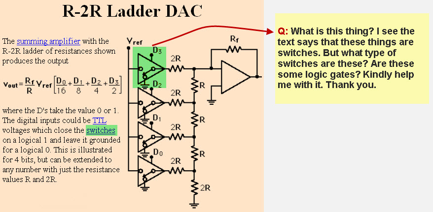

you can't use the 4066 as it is like a SPST, on or off. You need to either have the Rs connected to +V or Gnd, so you'd need a SPDT type switch. Like the original text says, it can be a TTL gate... yes, your original question was correct, you can use a TTL gate to drive each resistor high or low, if your +V is 5v. You'd need a 4000 series cmos gate to go higher.
Thank you, Mike.
So, then I can use CD4081BMS. The four AND gates can work as four switches. A standard TTL circuits operate with a 5-volt power supply. A TTL input signal is defined as "low" when between 0 V and 0.8 V with respect to the ground terminal, and "high" when between 2.2 V and 5 V.
Regards
PG
You can use a CD4081 but note that accuracy will depend upon the accuracy of the power supply which now becomes Vref.
You can use a 7805 or 7812 5v and 12v to generate you a stable supply.
Or for the most stable supply you could use a voltage reference IC.

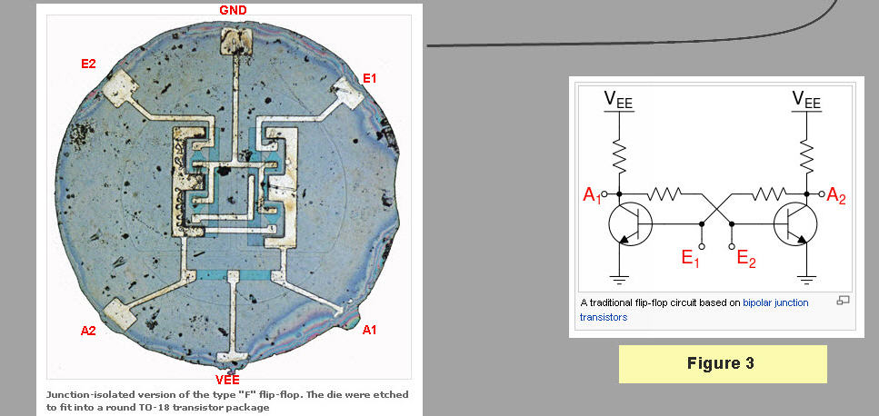

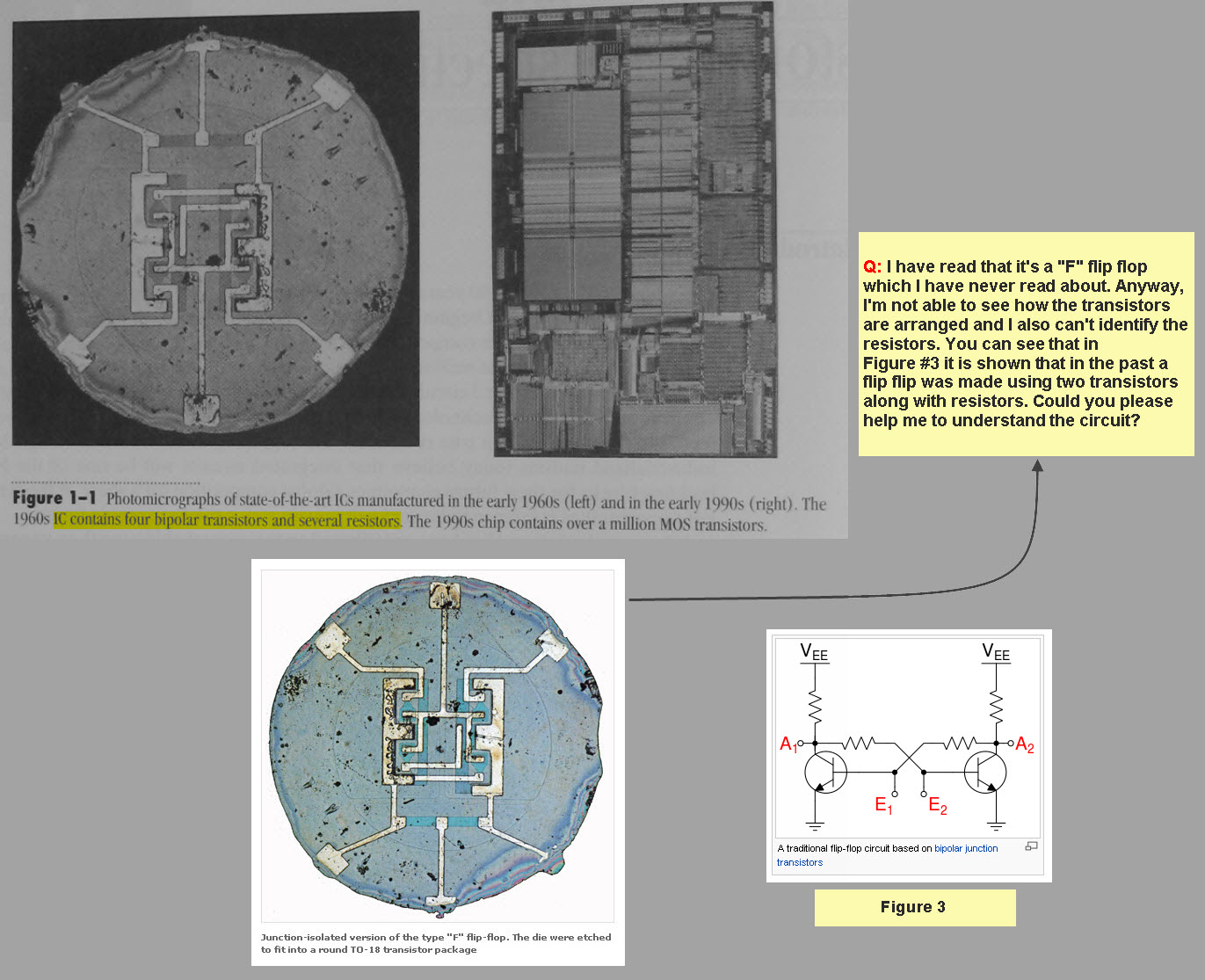

Hard to tell exactly where the etch resistors are but I think this is what you have based on the schematic. E1/A1, E2/A2 could be on either side.

PG, the manufacture of this stuff is a black art and your book is just pointing out the incredible increase in complexity and function in modern IC's over the 60 counterparts.
The original stuff tried to duplicate the circuit designs and components but the modern stuff tries to do away with components and rather uses controlled doping to provide resistance; controlled semiconductor dimensions to give varying current gain and constant current values to allow a wide range of functions and for the device to have stable characteristics. The modern IC design is driven by using as few masking processes as possible. Earlier designs of say audio operational amplifiers were specific designs. Instrumentation type IC op-amps were designed differently, but now, the masking process for an audio op amp is the same as for an instrumentation op amp; the only difference being the bias points and perhaps doping levels.
I reckon you will find it difficult to get a decent text book on the design/manufacture of modern IC's because much of what is done is highly proprietary.
I dont know what is a 'F' flip flop. My knowledge of F-F's is ; J-K; R-S; and D type flip flops.
