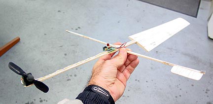

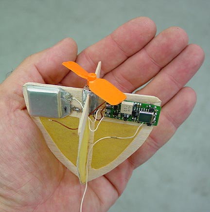

I've been pondering for a few days-- how hard do you think it will be to make those small, R/C Helicopters or Airplanes?
I know is is possible, but probably very hard. If we forget all of those controls, but for now being able to lift the motor in the air by itself-- how hard would that be / any ideas how one might do such a thing?
I'm really interested in building one, frankly I have no mechanical skills. It would be interesting to see it at least lift in the air or maybe just spinning around in my room. Any ideas?

If you are able to get the whole stuff you need via Internet I suggest you try to make an Indoor model, something like this:
http://www.smarttoolsinc.com/Model_Kits/TigerFly/TigerFlyConstruction.html
http://www.rcgroups.com/forums/showthread.php?t=181173
If you have no access to the control and those light weight lithium polymer cells just try a free flight indoor like this: **broken link removed**
Good luck

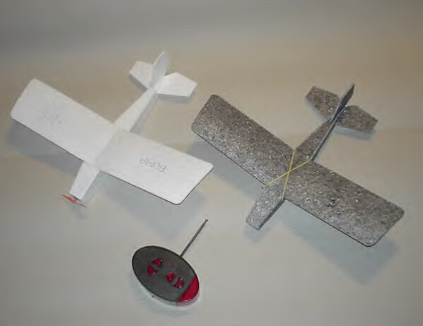

just try and read the below link:
https://www.rcgroups.com/forums/showthread.php?t=210688
then make a 'BUMP' plane according to the pattern by Michael Henriksen, you can find the plan in PDF in the above link.

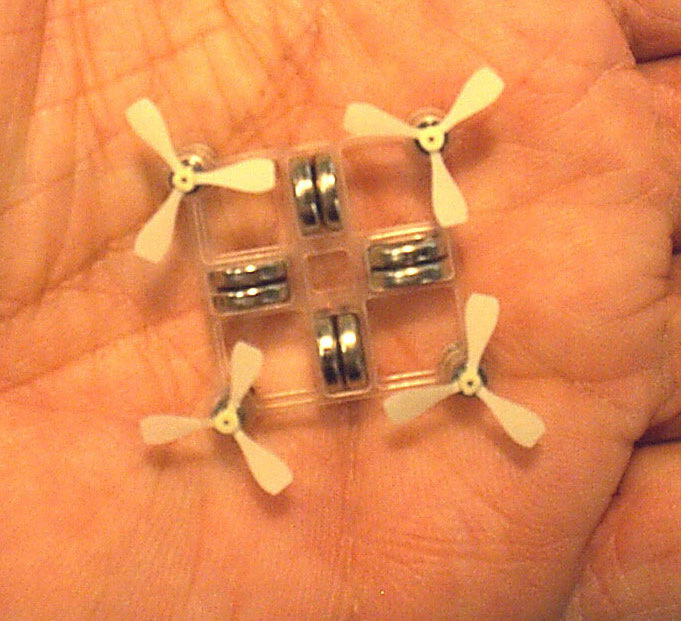

If you want something that just hovers just try this: :)

Wow, that is so cute. I only have two small motors, is it possible to just use two?
And for the propeller-- what material do you think works best for construction?
Thanks so much, I think it may be possible to just see it hover now, but maybe with a bit of work to control this too!

Well that is not so easy to be built I think. If you could make the whole propellers the same then you must consider the RPM for 4 motors (they must have the same RPM too).
