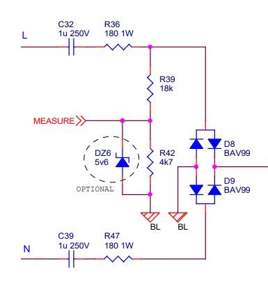

Came across this circuit and was not 100% sure (actually 10%!) what the 1u cap and 180ohm resistors are actually doing, I am sure you guys will know straight away.
L + N are 240v UK mains.

This is the classic capacitive (transformerless) supply.
They have split the series cap in two branches. Good safety feature, in case one capacitor fails.
The series 180 ohm resistor is to limit inrush current.
Just to expand on that, in case you're not familiar, the principle is to produce a potential divider which drops the mains voltage to the required output voltage.
In a "normal" potential divider Vout = Vin * R2 / (R1+R2) where R2 is the resistor that is connected across the load - R1 and R2 appear in series across the supply.
In this design, R2 is substituted for the combined reactance of R39, R42, ZD6 and the load on the DC side of the bridge.... the clever bit is that R1 is substituted for a capacitor. Actually, in this case, it's substituted for the series combination of C32, C39, R36 and R47.
But why is a capacitor substituted for a resistor? Since it is an AC circuit with a known frequency, the capacitor has a known reactance, Xc=1/(2*pi*f*C) and so, as far as the "potential divider" action of the circuit is concerned, it behaves as a resistor of this value. Unlike a resistor, however, it does not dissipate any power. And that's why this circuit is often used - it is a simple way to drop voltage without dissipating an impractical amount of power.
Hope this helps!
A resistor voltage divider heats the resistors, they might need to be huge and need a fan to cool them. A capacitor voltage divider does not heat the capacitors.

A little bit more history, the PCB's that matches the circuit are scrap PCB's I was salvaging parts from, I noticed what looks a common fault on several PCB's hence me getting interested in this deisgn, R36 or R37 have basically exploded, not both together, but on one board it will be R36 and on others it will be R37, I know this is a hard question that might be impossible to answer but what would be some common causes of these resistors exploding?

That's what the resistors are doing. They are absorbing the inrush current. Maybe the device is being switched on and off a lot of times and the resistors have gradually taken the "hit" many times and gradually failed.
The actual working current is very low 35mA so they have not overheated over a period of time. So, the only conclusion is the inrush current. Maybe the capacitors are still charged when the device is turned on again and this will create excessive current. That's one reason why the caps have 100k across them - to discharge the cap. Not so you don't get a bite from the pins of the plug.

The peak of a 240V sinewave is 340V. When first turned on the capacitors are discharged then the current at 340V peak is 340V/(180 + 180)= 944mA. Then the momentary power in each 1W resistor is (944mA squared) x 180 ohms= 160.5W. Of course the little resistor will soon blow up if it gets 160.5W frequently.

Dam I'm now getting myself confused how can it be inrush if the resistor array including caps limit the current :-(

When the caps are fully discharged, and you switch the power at peak sinewave, the inrush current might be 10 or 20 times larger than average.
I believe you are correct, that a NTC thermistor, rated for inrush limiting duty, is the best way to go.

OK got a ERZV05D471 varistor, (PDF Here) the PCB is rated at 5A but I think this is just for fusing, I think the average consumption is more like 2.5A, anyway, does it look like the right varistor for the job?
No
You are selecting a Varistor
You require an Inrush limiter NTC thermistor.
Something like these: https://www.digikey.com/products/en/circuit-protection/inrush-current-limiters-icl/151
Quote from a Cantherm datasheet:
Power NTC Thermistor. The MF72 series Power NTC Thermistors provide inrush current suppression for sensitive electronics. Connecting a MF72 in series with the power source will limit the current surges typically created at turn on. Once the circuit is energized the resistance of the MF72 will decrease rapidly to a very low value, power consumption can be ignored and there will be no effect on normal operating current. Using the MF72 Power NTC Thermistor is a most cost-effective way to curb surge current and protect sensitive electronics from damage.
