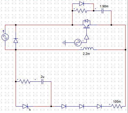

Ok i've now had time to attach a picture of my simulation. So you can see we have a current source in series with an IGBT switch & snubber with a load inductor and freewheeling thyristor/diode/resistor network. The thyristor is constantly triggered.
At time t=0 to t=0.001 the source supplies 1500A and the IGBT is closed. so the current flows in the inductor and the freewheeling components are reverse biased.
At t=0.001 to 0.02 The source current is zero and the IGBT is open breaking the current path (switching the sunbber into the circuit to eliminate large voltage spikes). The current circulating in the inductor is comutated to the freewheeling path. - i want to calculate the freewheeling current in the thyristor as this is a selection parameter.

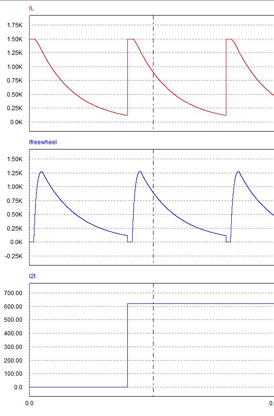

a graph of my simulation results is attached, showing current in the inductor (IL), current in the freewheeling path (Ifreewheeling) and the rms current (mislabled as I2t). The rms current measurment has a time constant of 20ms (henze the initial delay)
So i'm trying to work out my rms current - simulations on PSIM are saying 620 A(rms) - but i want to show this mathmaticaly (or disprove if thats the case)

So can anyone confirm my calculation? or find a reason for the discrepancy? It may be due to a snubber C value of 1.98 mF, all components in parallel, source, inductor, resistor and capacitor

The rms Value from my simulation is 620 A(rms).
actualy is should use 0.019 as the upper limit of my intergral as this is the time between swiches - the final 1ms of the 20ms period has the freewheeling part in reverse bias so no current

I just noticed you posted a waveform. That waveform is not just an exponential, but is both an exponential for part of the time and a pulse for the rest of the time (short time).
If that's the right waveform then you need to calculate the rms of the pulse too and add that to the rms of the exponential as the square root of the sum of squares. That will be the total RMS value of the wave.
Interesting that wave looks like it dips a little too low too for 20ms. You can check by using your exponential formula and calculate the lower value of current after 20ms (or whatever time period you are using) with a starting current of 1500 amps. Using the values you gave for L and R and 20ms time period it comes out to around 604 amps at the lowest point.
MrAl,
It's the rms current in the flywheel circuit i'm trying to calculate - i think you were looking at the inductor current?? The pulse you discribe relates to a current zero in the freewheeling circuit- this is why i'm only intergrating for 19ms not the full 20ms duty cycle
Hello,
Yes that's what i thought. So if you integrate from 0 to 19ms and divide by 20ms you should come out with a decent approximation. If the circuit is not as perfect as in theory though there are going to be some differences. If you are worried, create a more theoretical circuit and work with that first to see if you are doing it right.
