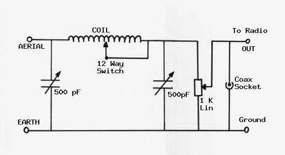

This sounds like an ATU (Aerial/Antenna Tuning Unit), it usually goes between a long wire aerial and a shortwave receiver - it's to match the too short long wire to the radio.

An ATU connects between an aerial and the aerial socket on the receiver, the sort of device you're talking about isn't likely to do very much.
One 'similar' sort of thing is a frame aerial, which is often active, and the radio can sit inside it, but it still needs a connection to the aerial socket.
IS the attachment a good ATU? I found the schematic on the internet.

DJ - I can't see the schematic.

Sorry my computor is acting up again, can't get the schematic to post right.
