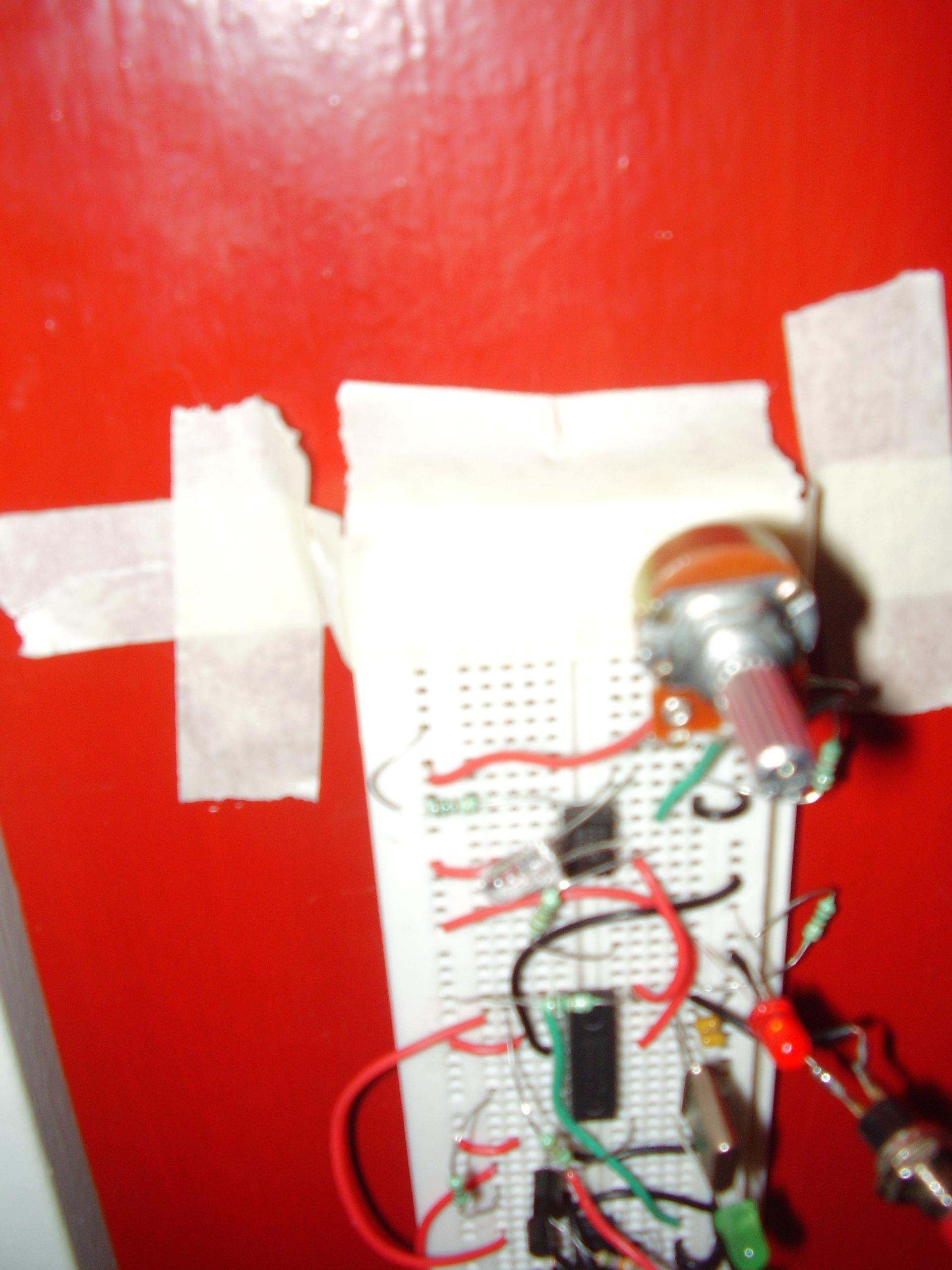

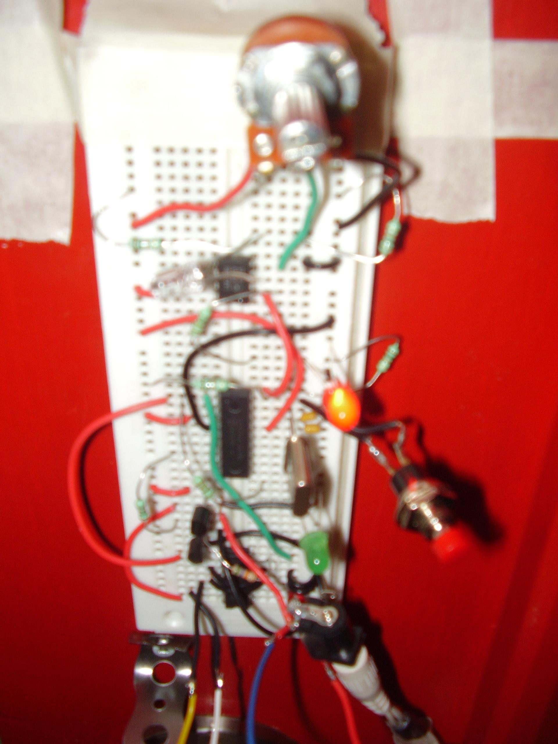

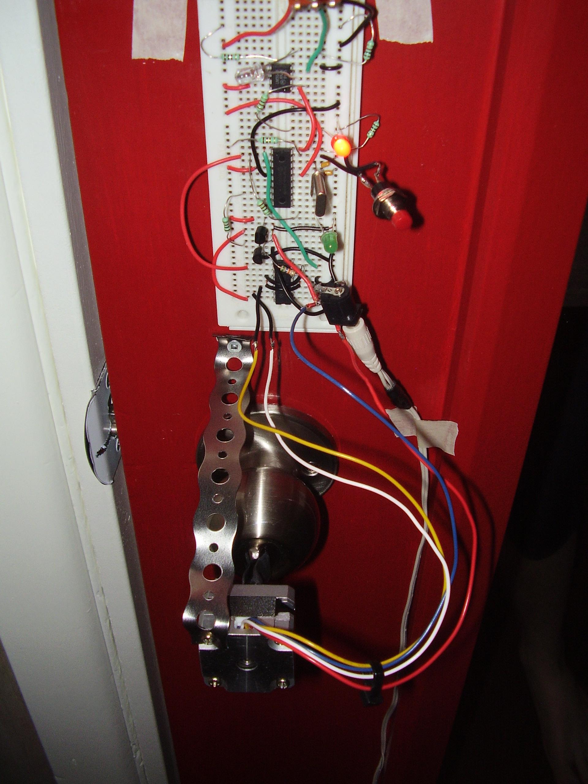

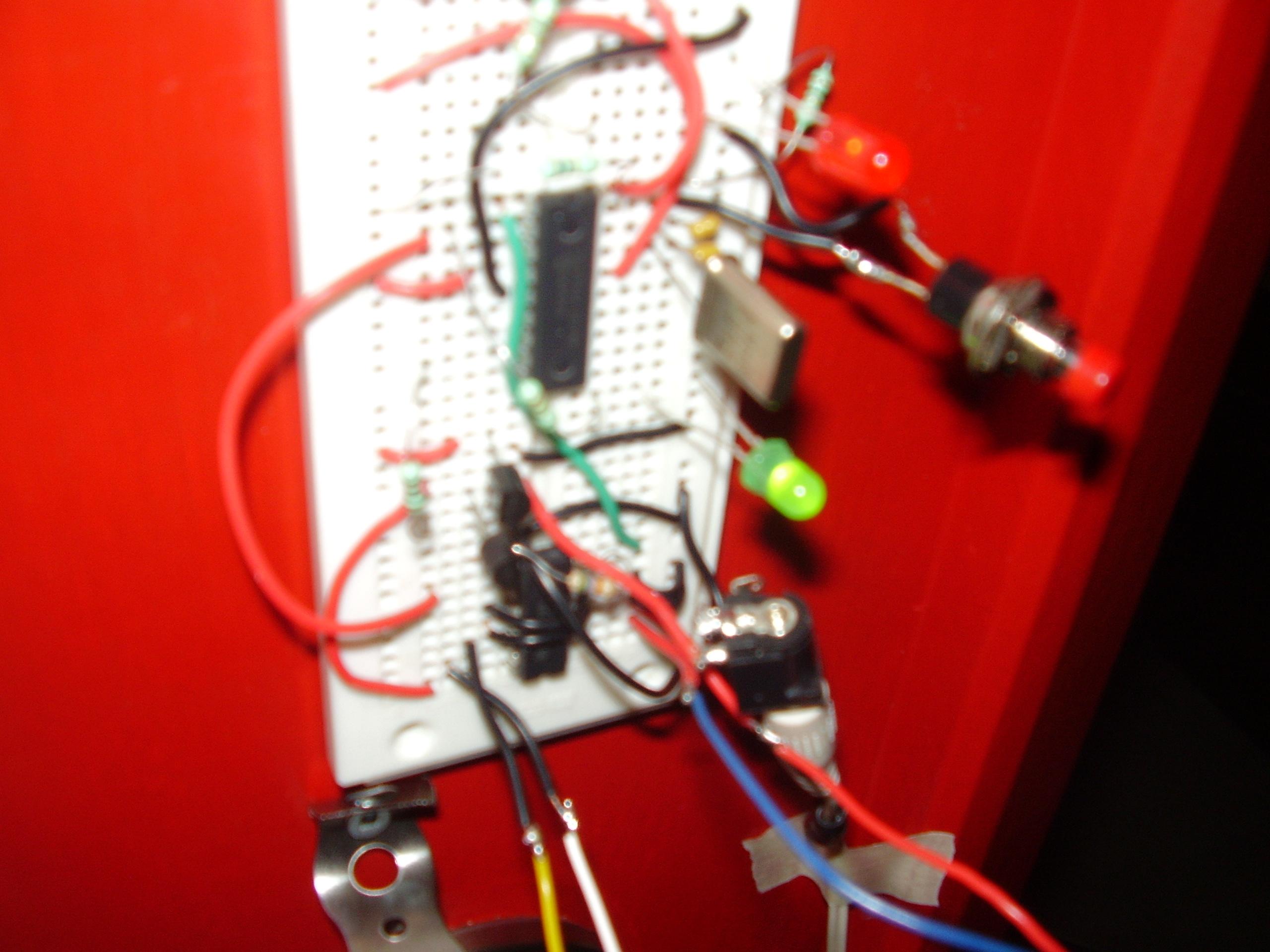

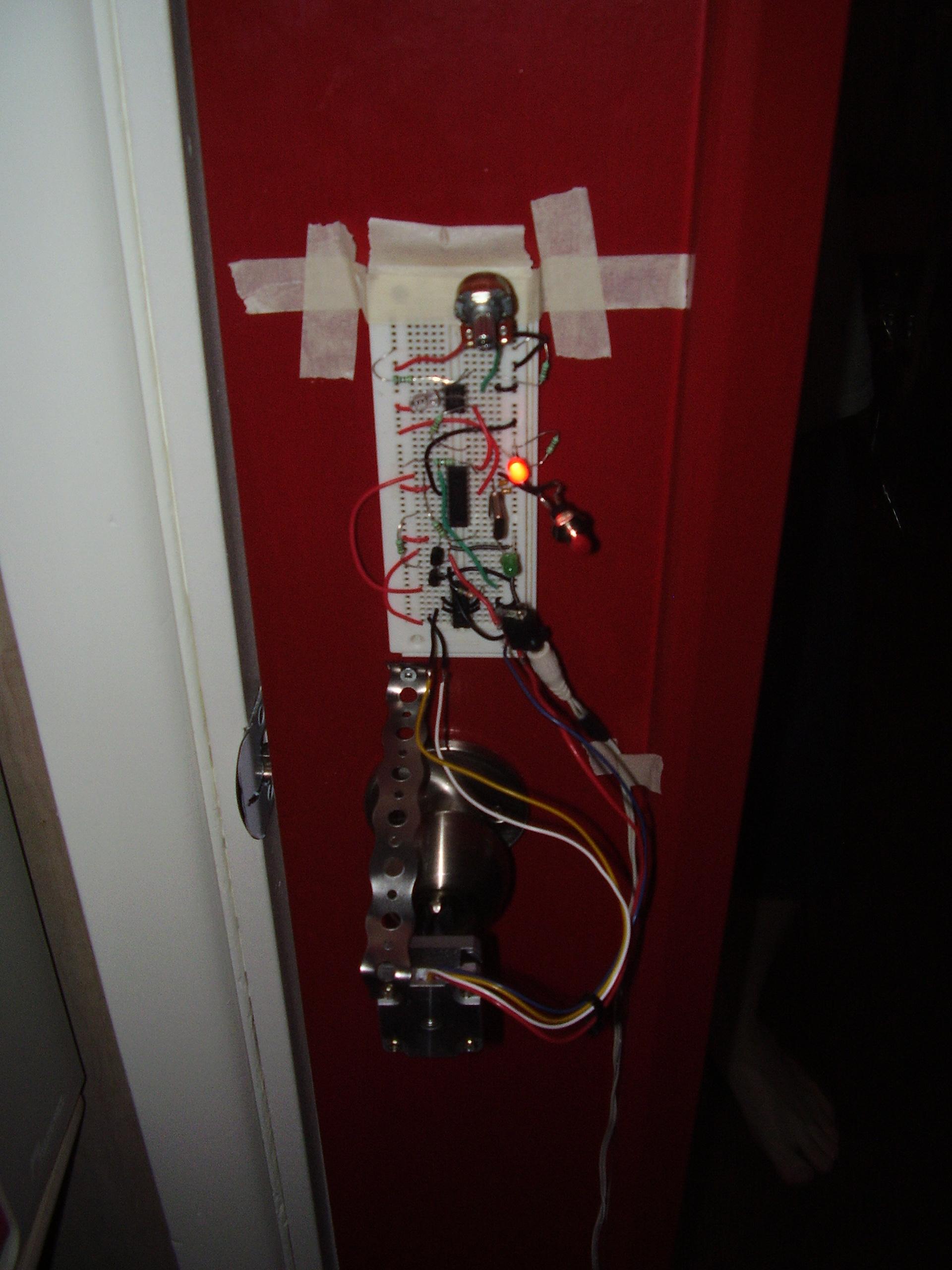

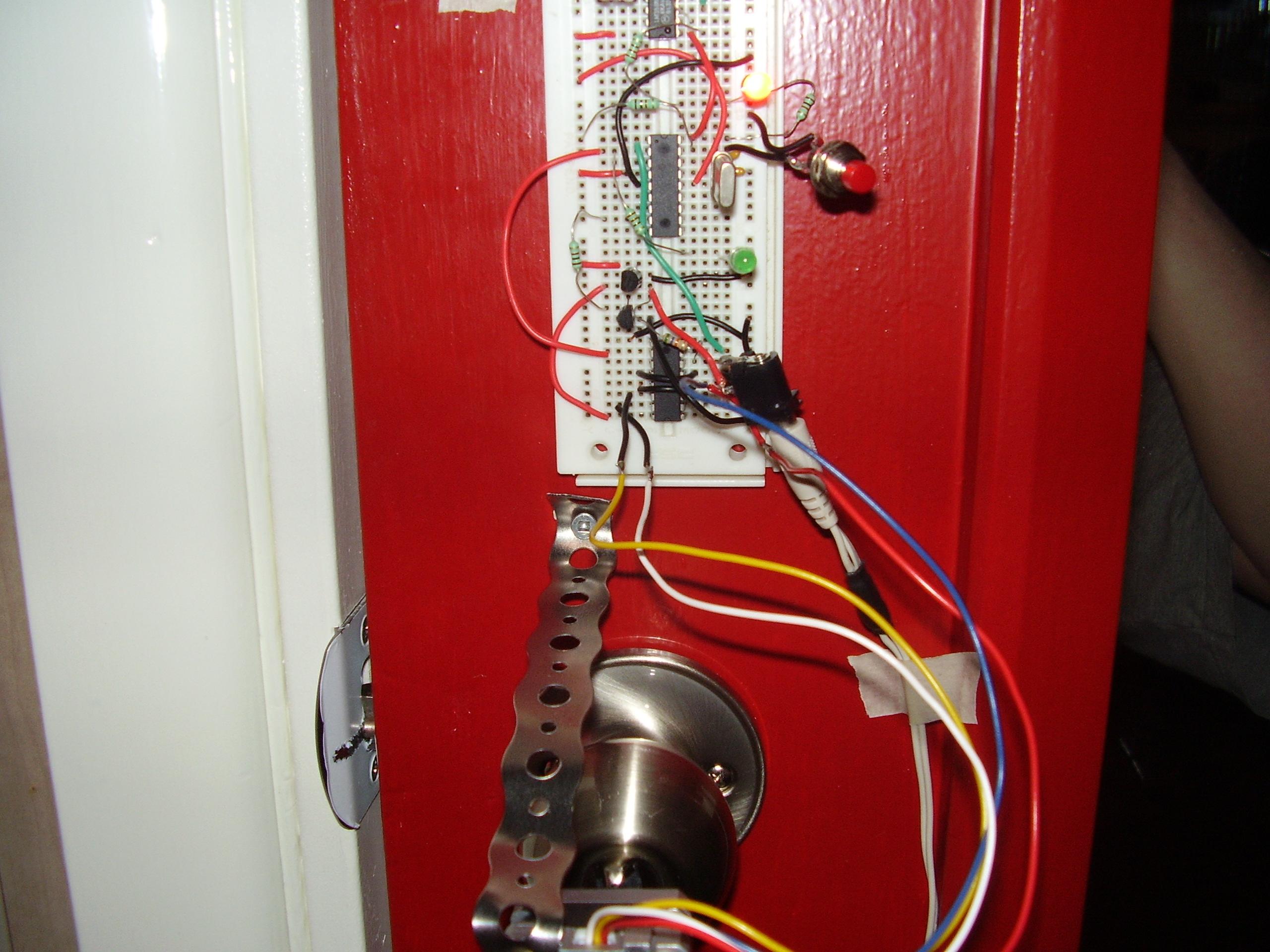

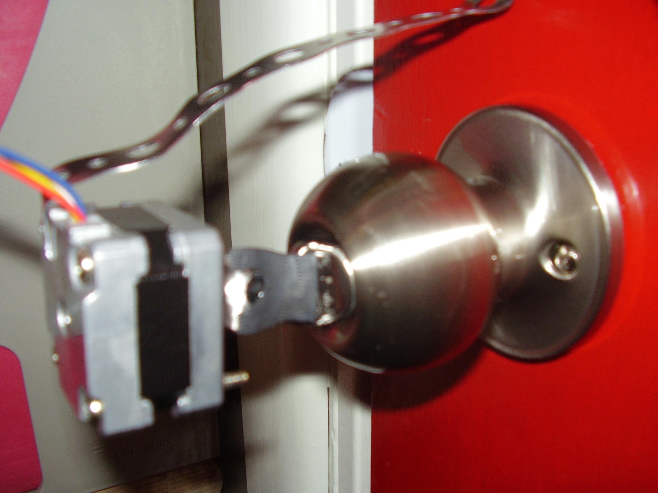

Here are some pictures of the circuit..
Keep in mind that it was made from scratch today and is no where near complete.
I will repost pics after I sort out this communication problem aswell as make the PCB and placed it in its enclosure.
Pictures:
I used steel strapping to keep the motor in place.
The black piece used to attach the blank shaft of the stepper to the locking mechanism was made out of the same steel strapping .. i used black shrink wrap to ensure the strapping does not scratch the door knob.
The black piece was then bonded using Lepage Expoxy #11
Top chip = LM358n
Middle = PIC16f84a
Bottom = MC3478
Stepper motor = bipolar
Power supply is 12v wall wart.
You can see the photo transistor at top.. it is clear.
The red LED turns on when photo transistor is subjected to light. (Just an indicator)
The green LED lets you know when the door is unlocked.
I guess radio control would be over kill for this.. the range needed is at most 20 ft.
I would use like to use IR but the modulation is throwing me off.
