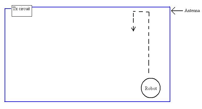

what i need is, the distance between the antenna of tx and rx should be very close to get connection. but i can't use ir, because i'm using my robot in dirty environment. the receiver is inside the robot, when the robot goes near to the tx antenna (less than 10cm if possible), once it receives the rf, it will change direction and so on. the rest is almost okay, my problem now is the rf circuit.

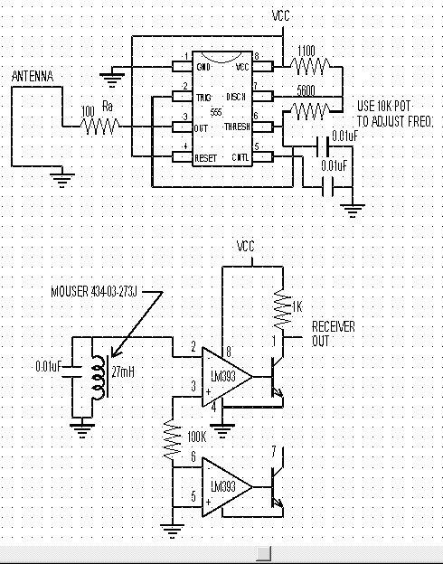

in this case , u wont need the txs described above.
since the "ant" encircles the robot, just pass a low/medium freq current thru that line at low voltage(need to be experimented) , the robot shld tune into that freq .
oh!! thanks.. but, i don't know how to construct low frequency tx and rx as well.. can u show me a simple circuit?? i can't find the circuit from the net also.. thanks
u didn't find anything from net .. :shock: :roll: .. ur app doesn't need freq stability , use a 555 osc ...

that last circuit is good, except that the following should be done:
Instead of connecting the output of the 555 to a pull-down resistor, do this:
Connect the output of the 555 to one end of a large value capacitor. The other end is connected to a grounded tank circuit. Stick the antenna at the point where the two capacitors are connected (one being in the tank circuit).
Set the values in the tank circuit so that its resonant frequency is the frequency you want to transmit on.
I do advise the coupling capacitor in order to prevent the output from shorting to the ground via the inductor.

i don't think these modification have any advantage in the present context , apart from adding complexity .
bananasiong said:
what is tank circuit?..
it is a heart of an LC oscillator , where the oscillations start.
what is the triangle thing? and what is the mouser?
the 'triangle' thing is an 'operational amplifier' or simply opamp
and mouser is a company , the number shown is their catalog number for that part.
I have included an attachment that shows the circuit. It should be easy to hook up.
And the advantage with this circuit is that the output is actually going someplace useful!
All that the current output is doing (without making any modifications) is giving itself to the resistor. and what I like to know is, other than generating heat, Why would anyone (with experience) want to just connect a grounded resistor to the output, and nothing else?
anyways, the tank circuit in my diagram is the inductor (the bottom-left-most component) and the capacitor (two T's with their heads almost touching each other) next to it. The coupling capacitor is the remaining component.
I suggest using a large value capacitor so that a large portion of the signal can be passed on. I suggest a 0.1uF capacitor. Capacitors do block DC, so there is NO chance of a short circuit.
Now on to the tank. The goal is to pick a low inductor, and a low capacitor value. and use the following equation to determine the resonant frequency (the frequency you will will be transmitting on).
f = 1/(2*pi*sqr(l*c))
pi is equal to whatever appears on your calculator after you press the "pi" button. sqr means "square root of".

oh i see! thanks a lot! so just ignore the word mouser... just get a same value inductor, am i right? from the transmitting part, the sentence "use a 10k pot to adjust frequency".. is it variable resistor? there is no variable resistor.. and.. for the receiving part, how do i know if i get the signal? don't we need to tune at the output??

Mstechca, you are an interesting character. It apparently never crossed your mind that Russ has been around the block a few more times than you, and might know something you don't. I don't want to imply that you know nothing, but you might want to consider that Russ is a retired engineer, while you are a hobbyist still struggling to understand the fundamentals of electronics. It would behoove you to ask how his circuit works, instead of proclaiming that it doesn't.
Russ's circuit is setting up a alternating current in the loop. This causes the loop to radiate an electromagnetic field. The receiver will pick up that field when it gets close to the loop. More current will be launched into that loop (which is an inductor, BTW) his way than you will ever get by trying drive one end of it off a tank circuit.
One way to improve the efficiency might be to resonate the loop (possibly a multi-turn loop) with a capacitor, and drive it with a transistor operated in class C mode.
A tank circuit is a high impedance parallel resonant circuit. It should be driven from the very high impedance of the collector of a transistor, not the very low impedance output of a 555 where it won't do anything.
