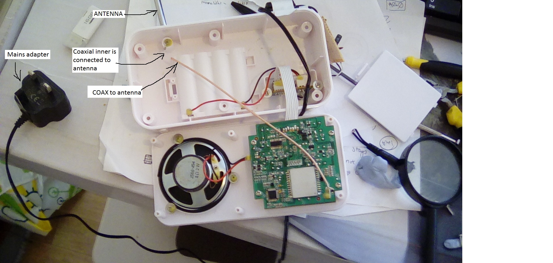

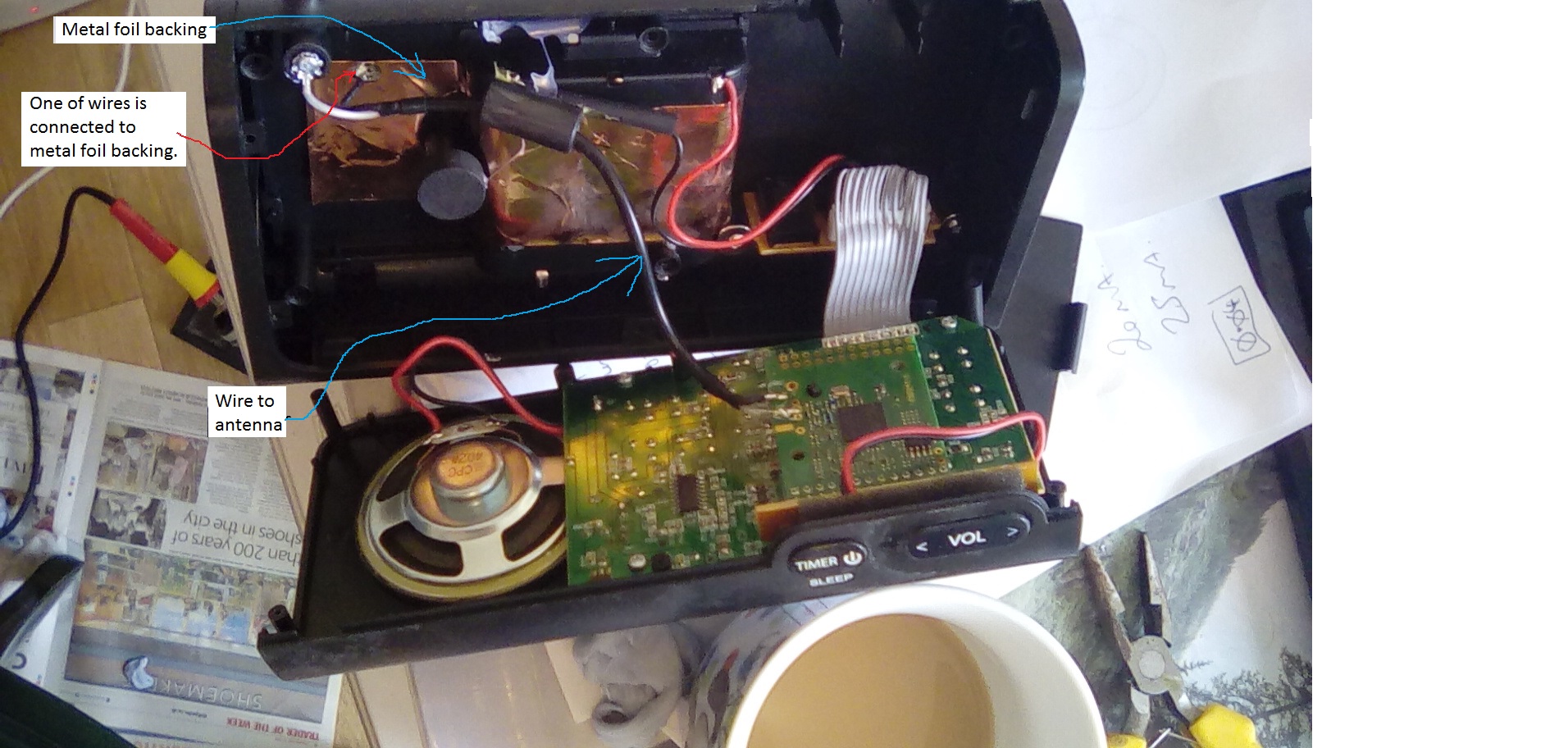

I have two DAB radios, a white one which has lots of bad fuzzy noise on it, and a black one which is fine.
However, the white one works fine when on batteries instead of the mains adapter.
I noticed that the (good) Black one has a metal foil area behind the main PCB (as shown in the attached).
The circuit ground is soldered to this metal foil.
The (Bad) White one does not have this metal foil. (as shown attached)
Both Black and White radios come with 5V,1A mains adapters, but the white one’s mains adapter is only 2/3rds the size of the black one’s. (I guess it also has less common mode filtering inside).
Anyhow, Do you think the metal foil in the Black radio acts like a kind of “chassis earth”, and helps in noise suppression?
The foil appears to be a kind of counterpoise or ground plane, a capacitive ground for the antenna cable braid.
You could try adding some self-adhesive copper foil to the one that does not have it? It's readily available on ebay as guitar screening foil.

well.......................... i just switched the adapters (for white and balck radios) ....and it was just as bad.
I then switched the adapters back as before.......but removed the electrolytic capacitor from the little LC filter that i wadgered together (as shown attached), and now the white radio is working much better with its original mains adapter....Uuuuugh OK.
I have been walking around the room (because it usually goes fuzzy when my body is in a certain place in the room).....but now there seems to be far less places where i can go and cause it to go fuzzy.....now i am only able to make it go fuzzy when i go right up against the white radio.
The mysterys of RF.
So anyway…it seems that having that electrolytic capacitor in the LC filter that I put in there (as attached) was the problem…….so this seems to confirm that having too big diff mode capacitors in an input filter can actually make the common mode noise worse…this is because the common mode can jump through the big diff mode capacitors and get to the other rail, from where it can cause EM radiation and interference…….would you agree with this?
