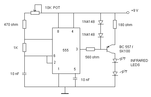

wil, see the attached circuit, it is simply the remote blocker you are looking for.
