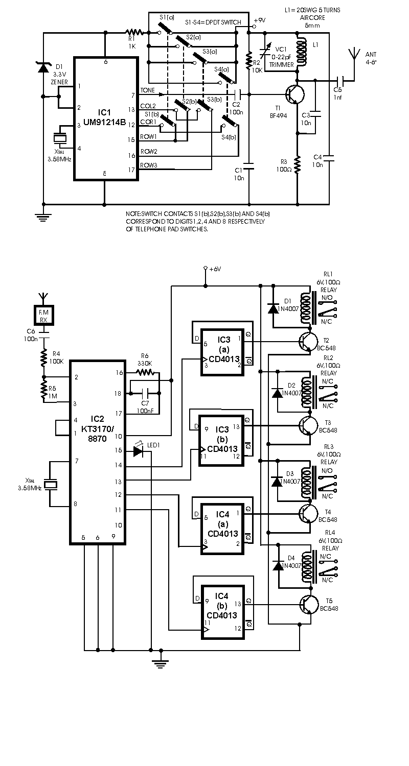

Here is schematic of a DTMF remote controller and receiver.You can use decoder and control upto 10 devices.
