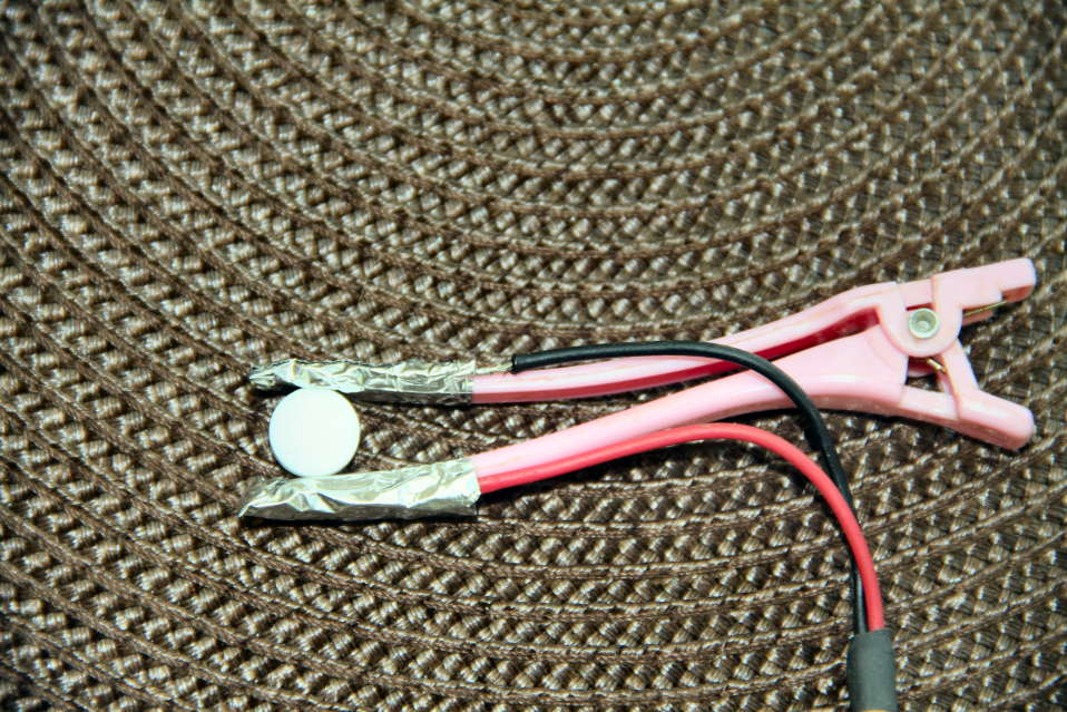

The accurate detection of something as complex as rain requires a very, very complex and advanced sensor system. Such a system must contain not only highly sensitive electronics but additional highly specialized mechanical engineering also is involved.
I have taken the time to develop such a system with help from my two lab assistants (Brandy & Biscuit a few pound dogs). Attached for your viewing pleasure is an image that represents countless hours of not just development but final assembly.
The white object held in place by the spring loaded jaws of the custom, absolutely one of a kind mechanical device is Acetaminophen a very rare and hard to obtain pharmaceutical. When a few drops of rain water (or any water for that matter) regardless of purity land on the detector of Acetaminophen a very advanced process takes place, it dissolves. This takes place under pressure provided by the highly advanced and developed mechanical device. The open jaws close providing a highly complex sensor output. Please note the highly rare alloy used to cover the tips of the mechanical device.
OK, so it is a an aspirin held in place with a hair clip. I didn't have a spring loaded clothes pin but you get the idea. :)

Working on it but the dogs who helped with the first design have lost interest. :)
Seriously I used that as a kid with a clothespin. The best aspirin were St. Joseph's Baby Aspirin as they dissolved real easy.
Ron
ah, who needs dogs anyways, they don't even have thumbs. gotta admit that's probably the simplest rain detector possible. I'll have to remember that.

Hi Ron,
you didn't describe how to get the aspirin in the highly sophisticated device.
I always pinch my fingers trying to do that. :(
