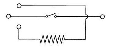

Is the diode a part of the relay circuit or do I add it (the coil looks a part of the relay)
#4
> A transistor or logic-level Mosfet can replace the relay.
Can you point me to an example of this please?
> But the 10k series base resistor value is too high
What size resister do you suggest?
Thanks,
Nic
The relay is a reed relay as attached.
Where does the diode connect?
What specs should the diode be?

While the schematic I posted was just the first I found in google images, the 10k base resistor will probably be fine (the relay pickup current is only 7mA, and the transistor won't be saturated with that current).
If the coil of the reed relay uses only 7mA from 5V then its resistance is as high as 714 ohms. Its wire must be extremely thin.
Years ago 24V relay coils were 700 ohms.
It's a reed relay, which generally have a higher coil resistance than standard power relays, as you know. The OP said the relay coil resistance was 500 ohms, with a pickup voltage of 3.5V.
