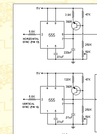

Hi, I am trying to build a VGA-to-scope converted as described in this website **broken link removed** which displays the computer screen on an oscilloscope in X-Y mode with Z input:
However, it does not work properly. The reason, as I figured out, is the absence of ramp output on X and Y axis (the z-axis output makes sense to me). I only got noises for X and Y axis.
The ramp generator used in the circuit is exactly the same as in this website
555 Timer-Ramp Generator - Electronic Circuits and Diagram-Electronics Projects and Design
However, I tried to build the standalone ramp generator with the specified capacitor/resistor values used and still can't get any output. Vout is always 0 volts.
Any ideas what I am missing? Can't believe I can't get something as simple as this working properly.
Where are you triggering from to the bottom [blue] ramp gen.??
Hi, the bottom is just a standalone ramp generator I took from the net to test if the ramp generator part of the first circuit is correct. If you notice, the connections of the blue circuit are identical to the ramp generator part of the top circuit. I hope that the author of the first circuit did not copy it from the 2nd website untested.
I tried various ways: grounding the trigger, connecting it to 5V, and supplying the VGA V-SYNC/H-SYNC signals. In all cases, with the values of the capacitor and resistors in the first circuit, Vout is zero. Can you perhaps simulate it and let me know if the circuit should work?
That 555 is wired as a monostable and it must have a trigger for every ramp.
Hi, since TRIGGER is active low, shouldn't connecting it to ground create a continuous ramp output? I don't understand why I always get 0V at pin 6 of the 555 timer. Connecting it to the VSYNC/HSYNC signals (which is what it's designed to do) also produces 0V at pin 6. Can you perhaps simulate it and show me the expected waveforms? Thanks a lot!
Connecting to 0V will not produce a continuous output, its a monostable, for a continuous ramping you would need an astable config for the 555.

You must have the Vertical and Horizontal sync pulses connected to these two 555 ramp generators, then you will get the two ramps...OK.?
They have been drawn as outputs, but are inputs...

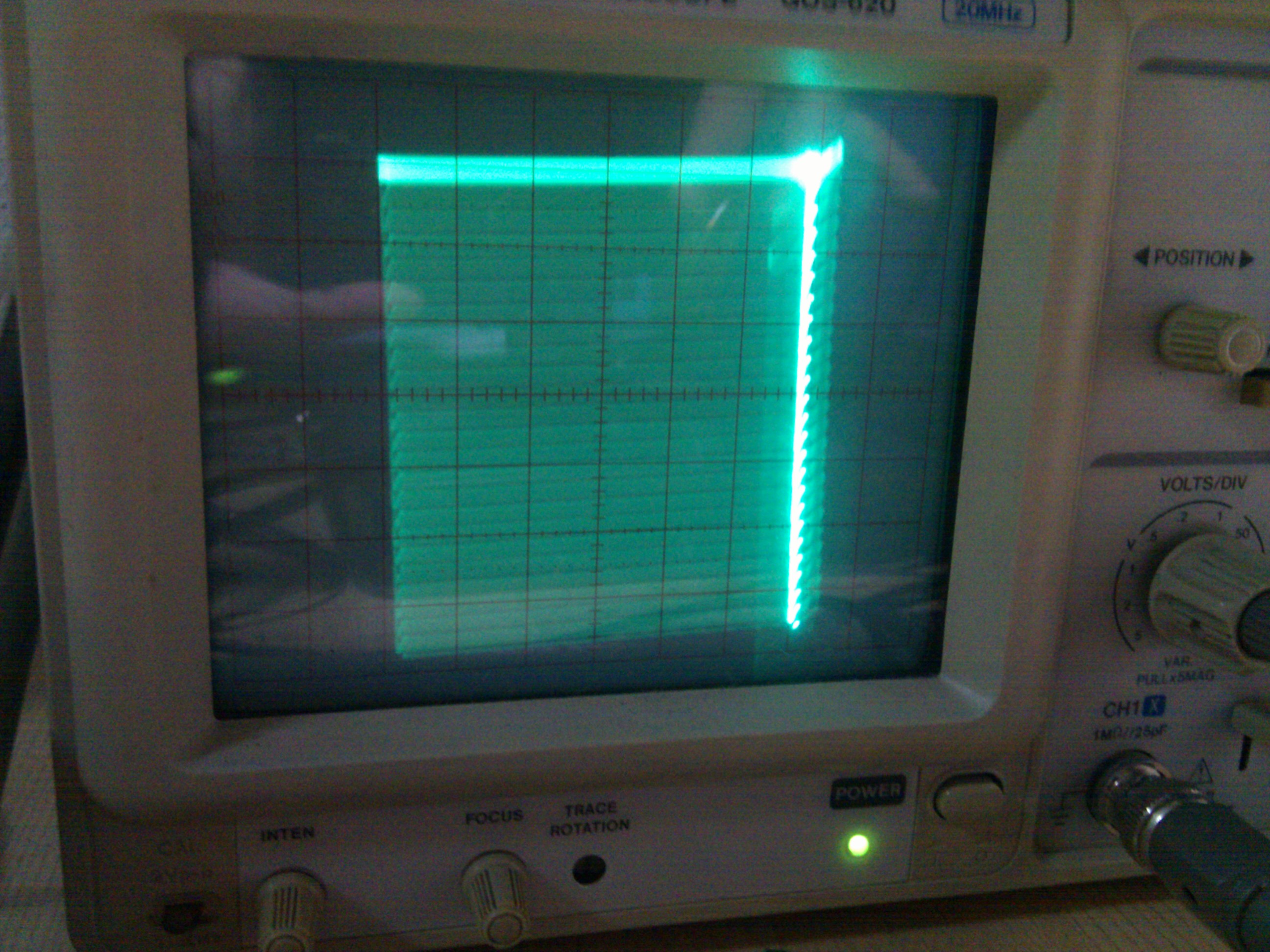

After gaining some understanding of 555 timer monostable configuration and ramp output, now I believe I am getting very close. I get ramp output at correct frequency on both X and Y axis, resulting in a raster scan, and thus a rectangular display on the oscilloscope (see attached).
However, now my Z axis seems not working. The output voltage is around 1V only and not enough to lower the beam intensity. My oscilloscope needs at least 5V for the Z axis to affect the intensity. I am not sure what's wrong but have the following questions
(1) Am I understanding correctly that the resistor network on the left of the Z-axis part of the circuit is to sum up the voltage values for R, G, B proportionally (based on the resistor values) and create a grayscale signal? If this is correct, then the values are non critical and I have chosen the closest values that I have.
(2) What is the maximum expected voltage output of the TL082 opamp? Is it 14V - the difference between the power supplies voltage?
(3) What are the 2 50k trimmer at the X and Y axis for?
Thanks!

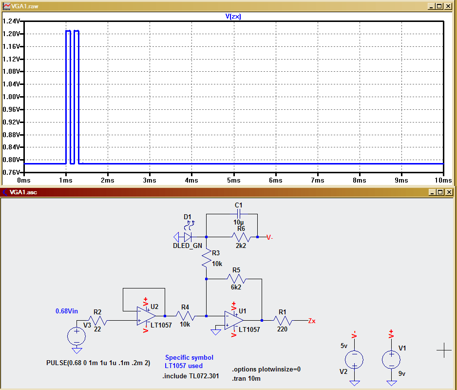

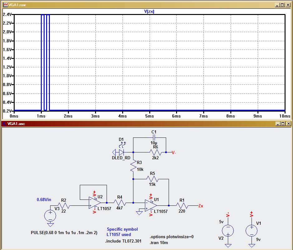

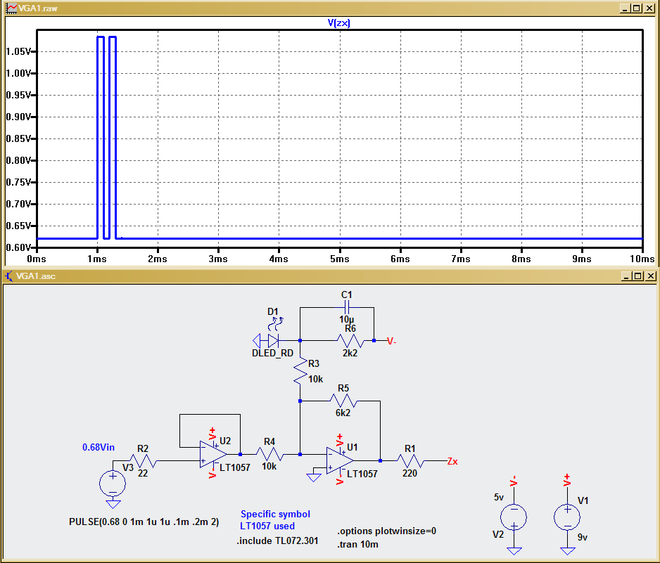

OK,
What colour LED are you using.??
Hi, for a standard Windows desktop, multimeter reading shows V(pin1) = V(pin2) = V(pin3) = 0.12V (approximate) at the Z op amp.
At pin 3 (grayscale input), oscilloscope shows Vmax is approximate 0.68V and Vmin is 0V.This is within VGA standards. Waveform at pin3 seems correct and responds to change in screen. Waveform at pin 1 shows some response to the change in screen but totally distorted.
I am not sure what happens but now all I get at pin 7 output is 8V DC sharp (straight line on oscilloscope) and the oscilloscope screen stays blank.. Voltage at pin 6 is -0.02V which was -1.2V before the interconnecting 10k resistor. Very strange, the connections have been checked hundred times. Tried to replace the TL082 with same results.
Also I am using a 24pF capacitor since I don't have 22pF. If it helps, the supply to the Z op-amp is not exact, around 9.3V and -4.8V.
Using a 0.68Vin for Brightness.
These 3 images are for the original circuit with a RED and then GREEN led.
Image #3 is with two resistor changes on that OPA.
I have also simmed the two 555 ramp gens if you having a problem with those..
NOTE: Start with scope brightness LOW, if the ramp generators are not running you could spot burn your scope screen....
