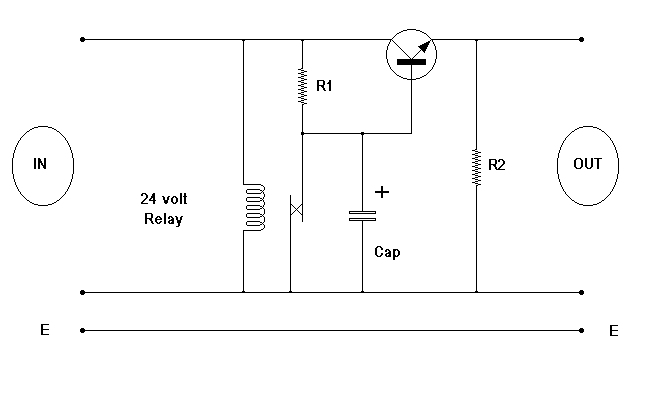

I am looking to purchase a Windows CE based computer for a project. I will power the computer from an external 24 VDC power supply. The system has the following requirement: "At input voltages between 14 and 24 VDC, voltage must be ramped up at a maximum rate of 1V/mS."
Because it is possible to plug in the connector with the power on, I cannot count on the power supply to ramp up the voltage. Is there something simple I can put in the power line to absorb some of the voltage when the unit is first plugged in--a choke or something?
The minimum power requirement of the system is 500mA at 24 VDC. The power supply is capable of producing almost 4 amps at 24 VDC and will be used for powering multiple pieces of equipment so whatever I do, it can't affect the other equipment on the power supply.

A choke would give a surge at switch-off, might not be a good idea.
At the currents you mention, i would suggest a power transistor (or
FET) in line, just to give a twenty odd milli second rise time to
full supply.
With an R-C on its base.
Suggest using a C/O switch, wired to short the cap at switch-off,
so that switching off the unit,
then quickly switching it back on,
would not stop it from going through ramping up.

Such a circuit would be very simple.
You would have to choose the component values to suit yourself.
The transistor, or FET has simple requirements,
adequate voltage operating, and adequate current rating,
there are many that could suit.
FETs are a higher impedance device, and may be awkward to use or
to set up. For a novice i would suggest a power transistor instead.
But that is up to you, or whoever you get to construct the unit.
R2 is a dummy load, a medium to small resistor just for stability.
Maybe one or two thousand ohms. One or two watts.
R1 should be chosen as a value which will drive the transistor(or FET)
a little way into saturation. (without the cap connected of course)
The Capacitor would determine the rise time, which would not be linear
but would not matter for this purpose, and would be chosen to give a
suitable interval of rise time.
Making a long interval would make the transistor heat up, so during
trying out values bear in mind that its intended for short intervals,
long intervals may make the transistor overheat.
I imagine values of less than 10 MFD would probably be in the right area.
I have not made this, although i have made other similar units.
The function of the relay is to make sure that the cap is discharged
if the unit is turned off, then on again by accident, this will make
the unit ramp up again, as required. Its contacts are to be normally
closed, that is connected, when the relay is at rest.
Before attempting any construction, please wait to see if any others
have any comments, others may have made similar units, and might be
able to suggest or recommend likely components or values.
If i have drawn it incorrectly, i'm sure someone will soon say so.
Regards, John :)

John,
I think I can find a transistor that would meet the voltage and current requirements and a datasheet could let me know how to drive it. But, how would I determine the value for the capacitor? I have nothing to measure time if it were by trial and error.
Would a 2K resistor across the cap work instead of the resistor for the power-off function or would it mess up the timing of the cap?

Hi Dale,
Thank you for your excellent reply.
I think i now understand what you were concerned about,
and what you thought might address your concerns.
Not really a test, but a way to gauge what was bothering you.
I think you were concerned about the contacts shorting out the cap.
You are correct to check that out.
Shorting out charged up electrolytic capacitors is not a good idea,
unless they are quite small values, and the charge voltage is low.
In this case, below ten micro-farhads, and twenty four volts will do
no harm. After testing the time interval the cap will probably turn
out to be less than five micro-farhads. That is just a guess, it will
depend on the R1 needed to push the transistor into saturation.
There is no resistor in that discharge loop because that is intended
to discharge the capacitor fairly quickly, so that if the supply is
plugged in live by someone wiggling the plug, or gets switched off
then back on quickly, then it will still do the ramp-up that you want.
A relay is a mechanical device, but the delay caused by its inertia
is very small, and is at the start of a small deliberately induced
rise-time, i don't think it is a concern. The rise-timing would not
start until the relay has operated, and opened its contacts, allowing
the cap to charge. Its job is not really to drain off the capacitor,
it is to ground it out quick.
Significantly, it is the absence of a supply feed that closes the
contacts, which can be done quite simply using a relay, but could be
complicated to design using electronics.
And you are quite correct, R1 will draw more current with the contacts
closed, i can only guess at a likely value for R1 for i don't know
the transistor (or FET) that you may be using, it could be around 300
ohms to push the transistor into saturation. (just a guess)
Which means that it would take around 80 milliamperes initially.
Once the relay operates, and the cap has settled, the base current
comes through the load anyway. Actually 300 ohms sounds a bit low,
you will have to check your data sheet.
The transistor is not used as an amplifier, it is used like a switch.
The value of R1 has to put the transistor into maximum conductivity.
But it is used a bit like an amplifier briefly, for the rise-time.
During this time the transistor has to handle significant wattages,
fortunately this time is brief, and the transistor should not get hot.
You quite obviously have a better grasp of what is involved than you
say. Which is why you have picked up on the apparent problem of the
contacts shorting an electrolytic. With these low voltages, and low
capacitance values, it should be Ok.
If there are others looking in, perhaps they would care to guess at
a capacitance which would give about twenty milli-seconds rise-time
for that transistor .... and it would only be a guess without the
number of the transistor. My guess is about five micro-farhads.
I did not mean to go into so much detail on my reply, but i am very
impressed by your grammar. Which appears almost faultless.
And i am impressed by your spelling, which is at least as good.
And your correct syntax, you were wondering, not wandering.
Only one slip, which shows you weren't using a checker system.
Regards, John :)
Hi Dale,
I forgot to mention,
that introducing a resistor(Rx) across the capacitor
would make R1 and Rx form a voltage divider,
which would probably prevent the transistor from reaching full
conduction.
This is bad for the transistor as the heat generated within it
is a factor of the current multiplied by its voltage drop.
Whilst either is very low, the subsequent dissipation is also low,
thats 'Amps-times-Volts',
but if neither is very low, then the 'Amps x Volts', (dissipation)
can get quite high.
Briefly: Max current is ok with very low voltage,
and its max voltage is ok with very low current,
but in-between you have to be carefull.
I hope this is not confusing, some people find these things difficult
to picture.
And i am surprised at the lack of any other response to this thread.
Are you sure that this requirement for a rise-time is not just the
manufacturers being a bit picky ... ?
Is it really necessary ?
See what others say before getting involved in making a 'Special
switch'
for this unit.
Regards, John :)

hi dale, john
The circuit you have drawn looks fine, the only minor addition I would suggest
is a diode [1N4001 type] across the base/collector junction of the transistor.
Cathode to collector, anode to base.
Consider the instant the external input is switched OFF, that is the relay is energised.
Depending upon the release speed of the relay and the closure of the relay contacts
and the fact that the Cap is charged. You could momentarily have a situation where
the base/collector junction voltages are reversed . The diode would protect the transistor
and also help dump the charge on the Cap via the relay coil.
A final point would be the sequence in which the ext supply [bty] and the ramper cct and computer
are switched ON/OFF. It may require an extra diode across the emitter/collector junction.
[cathode to collector, anode to emitter], this is to prevent the transistor being damaged
due voltage reversal.
Regards
EricG
Taking a closer look at the circuit, suggests that the relay, with D1 diode
in circuit, is redundant. Just replace it with a suitable resistor.
Provided the user avoids rapid ON/OFF switching of the system.
Again it depends upon the system ON/OFF switching sequence.??
