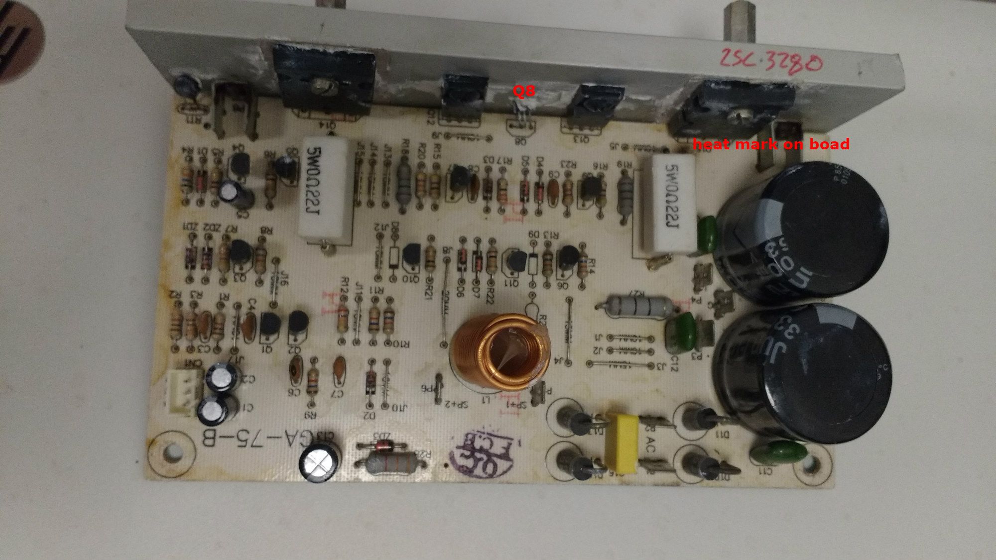

I'm trying to fix a Randall RH100 that is having an ugly and thin distortion signal even in the clean amp. It used to be a very good clean, now it is like a bad radio with too much volume in it.
So far the symptoms:
- It has sound but thin and distorted, even in clean.
- volume is lower than usual.
Procedure so far:
1. I tested to check if it was the preamp or the power. The pre amp is fine, sending a good clean sound through the "send out" and through the headphone (also before the amp).
2. I tested the speaker and it is also fine.
3. I tested the guitar and it is also fine.

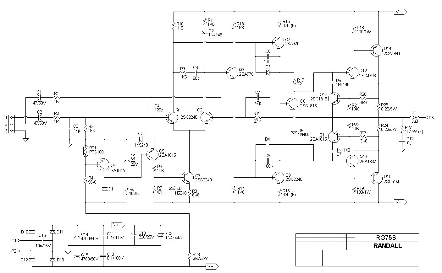

I couldnt find the schematic for the GA-75-B (written on pcb), but i found the one in RG-75B and they are very similar. Below:
randall-rg75b-power-amp-sketch-gif.55060
The difference from mine is that the Q15 is a toshiba 2SC3281 not a 2SC5198 and the Q14 is a 2SA1553 not a 2SA1941. This might've been changed when it went to repair two years ago. But, apparently, as shown below, there is no visible fault (see attached picture).
My suspect is the q15, due to small burning nearby. But might've been from the first time it went to repair, 2 years ago. Anywhere to start? It has too many transistors to change.

The RH100 amplifier is a pretty conventional design and finding the fault should not be too difficult.
The symptoms that you describe do suggest that one half of the output stage has blown as you mention.
The circuitry around Q4 and Q5 looks complicated but it is fairly straight forward and has two simple functions:
(1) To mute the amplifier at turn on to prevent thumps and clicks in the speakers (C5 & R5).
(2) To shut down the amplifier if the amplifier overheats to protect it (RT1).
A fault in this area could also give the symptoms that you describe.
Q10 and Q11 protect the output stage from over current. A fault in this area could also cause the symptoms you describe.
The schematic for the Randall RH100-G2, which gives a bit more information but otherwise is similar to the schematic you have posted, is attached below.
spec
(PS: I see you are from Brazil; care to put that next to 'Location' on your user page so that it shows in the window at the left of your posts)
One way to locate and fix the fault/faults on your RH100 will be to use a digital multimeter to make various voltage measurements and possibly current measurements, which I can define.
It will then be necessary to desolder/unscrew components and replace them with new, possibly more robust components.
It will also be best to correct any inherent problems with the design: off the top of my head the quiescent current control in the output stage looks as though it could cause excess dissipation in the output transistors and the heat sinking appears to be rather skimpy.

Since the parts are kinda cheap, I bought most of the transistors (except the two output ones q15 e q14) and so far i've replaced the ones showing signs of excessive heat on the board (Q9, q10 and q4).
Initially the sound was beautiful again, but after 15-20 minutes of use, it went back to the same problem. So i probably hit the symptons, not what causes it.
I don't have an osciloscope to test the sign. Planning in buying a two channel one.
Q8 tends to heat too much, despite having no signs of damage or overheat, it will be my next target.

In this design it is clear that they expect them to get hot. It is the only TO92 transistor that literally goes inside the heatsink.

Q8 and D5 maintain the quiescent current (normally around 20mA) in the two output transistors. They do this by tracking the two VBEs (Voltage Base Emitter) of Q12 and Q13, each of which drop by 2mV per degree C increase in junction temperature. The reason why Q8 is in thermal connected with the heatsink is so that Q8 heats up as the heatsink heats up, so its voltage also drops (approximately) in sympathy with the drop of the VBEs of Q12 and Q13. Q8 self dissipation should only ever be a few milli watts. Note that the heatsink is only heated by the output transistors Q14 and Q15, but as Q12 and Q13 drive Q14 and Q15, Q12 and Q13 get hot in sympathy with Q14 and Q15 (hope you can follow all that).

(1) The first thing to do is to inspect the board for any broken tracks, dry joints, or broken components. Any joints that look suspect reflow with new solder.
(2) The next thing to do is to check the frequency stabilizing components (probably easier to simply replace them all):
(2.1) C8
(2.2) C9
(2.3) C7
(2.4) C12/R27
(3) Make sure that the cases of the output transistors are not shorting to the heatsink.
(4) There should be two big capacitors connected from the plus and minus supply lines near to the amplifier to 0V. Make sure these are connected and are not leaking or bulging. Check the values if you can.
spec

Hi Specs, I`ve did some voltage tests in some transistor and the Q8 was odd. So i changed and the amp got back to normal.
Thanks a lot for the patience. I am still crude in this, but this forum is fantastic.
