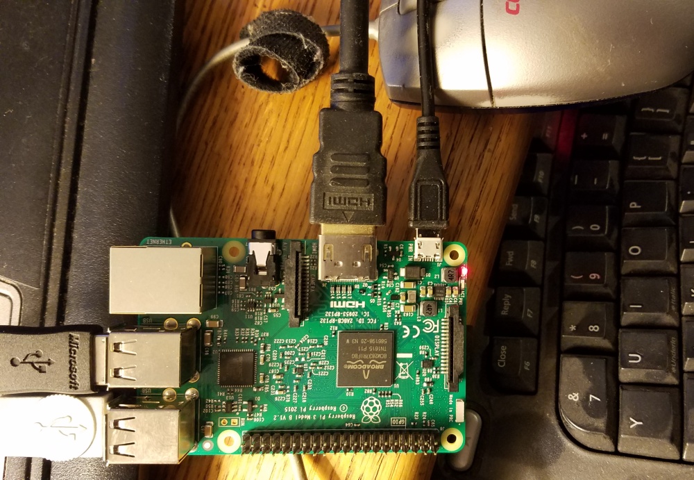

1) Got a Pi 3 from Element14.com It has about the same power as my laptop computer. $35.00
2) Many people have warned about using a small power supply. So I got the "5.25V/2.4A Micro USB Switching AC Power Supply". Model # 28-19336.
3) Had some trouble getting the last computer up and running (down load, unzip, format SD card, (get the right format), put the files on CD. So I got a 16gb CD card with "NOOBS" on it. So it should work. lol
1) Plugged in USB keyboard and USB mouse into the ports. Have a very nice wide monitor with HDMI cable. (odd format) Plugged in power and nothing.
2) Put the CD into the computer and it has files.
3) Nothing again.
4) It looks like it is booting. Green light blinks like it is booting but nothing.
5) Found a more standard 1280x1024 monitor.
6) Boots up :)

Good news. It ran all night.
My last computer was a PC Duino. I updated its software with out using a PC to help.
Update system:
"sudo apt-get updates" from the command line in LXTerminal
Update programs:
"sudo apt-get dist-upgrade" from the command line in LXTerminal
MENU-Acessories-Terminal will get you to the command line.
You may be asked about "using more disk space" =Yes
App upgrade may take a while. It needs to go get all updates.
