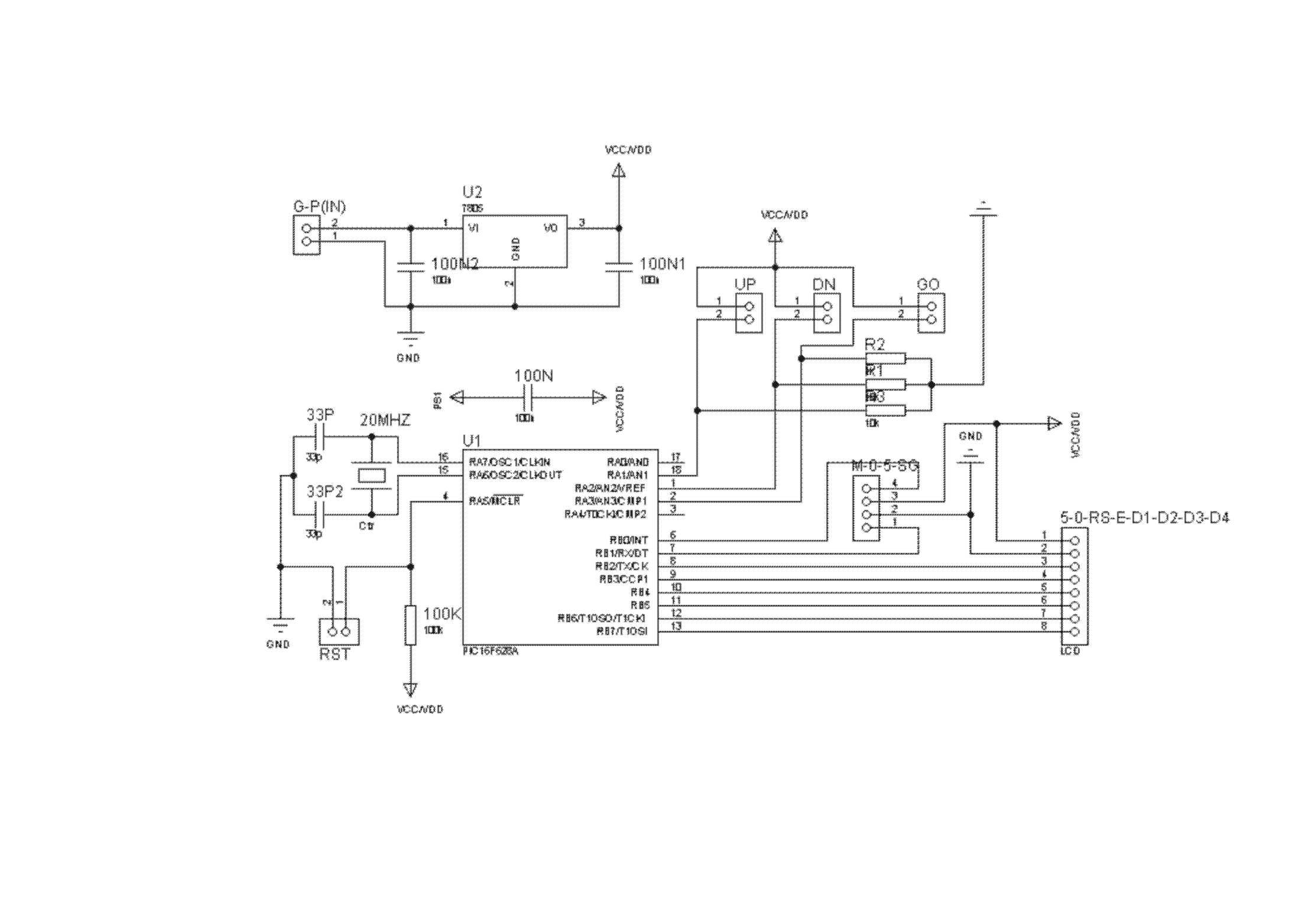

i made a simple circuit attached.
to count interrupt at RB0, the software start and make u edit the number of pulses and then start the interrupt , when the number of pulses reach what u want , it stops
the pic is attached to push-switch and lcd via sockets.
the circuit works very well on easypic 3 where rb0 is attached to pulldown resistor of 10k
when i made the circuit outside the devboard
i get solid blocks all over the lcd, untill i connect RB0 to +v, then it works !!, if i try to pull it down as in easypic3 , it wont work, attach a resistor to +v , dont work
i tried everything
setting pin as input , as output, pulling up/down floating pins , nothing works except connectin RB0 to +5V ,
but then how can it count if its always connected to +5
i will appreciate any help please
thanks
circuit, forget to attach it

hello.
i tried everything
thanks

You should have a pullup resistor on RB0 if you are using a switch as an input.

defining the interrupt from hi to low or opposite is not important for me , however i would like to know how can i do it
again this worked fine in the easypic3
i tried offcourse pulling rb0 up and down with no result .

look in the circuit above the pic ;)
capacitor in series , now how lame is that

Looking at the dwg, the 33pf caps are not in series with the crystal but connected either side of the the crystal to 0V, which is correct.!:p
They are too high a value for a 20MHz xtal.
What did you do to make it work.?
i didnt mean these caps
i meant the cap connected to PS1 to Vdd , that supply power to the pic
i connected the pic to power through a series cap, it should be parallel which made the pic power fluctuate and make strange things
when i connect the RB0 to power it some how supplied power to the pic and made it works .
i fixed that and connected the pic to power through parallel cap , pulled down RB0 and everything is ok
