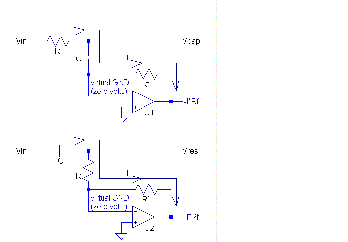

I want to see the phase difference between current and voltage in a simple RC circuit on a oscilloscope. How to do it? Is it possible?
It can be shown in XY mode but can it be shown in normal mode?

This will work if your input rise and fall times are long enough for the op amp to handle them. For a 741 op amp, this is around 10usec. You can use a wider bandwidth op amp if you want to use faster risetimes.
Sine waves will work pretty well up to around 10kHz for a 741.
This will only work for peak currents up to the output current capability of the op amp.
A much simpler approximation is to forget the op amp and add a series resistor in the ground lead which is much smaller (<1%) than the R in the R-C circuit. The voltage across it will be proportional to the current.

Hi Ron,
what i am interested in is that there is a simple circuit having two components, a resistor and a capacitor. now as the capacitor current will be leading the capacitor voltage, i want to see two waveform i.e. current and voltage waveform on the oscilloscope showing the phase difference.

That's what he drew for you, the resistor and capacitor are labelled R and C, the other few bits are to generate the current reading for the scope.
I thought it was a rather nice solution!, my first thought was a small resistor in the bottom of the capacitor (as he also mentioned), but his opamp solution was far better.

1. Yes
2. The oscilloscope only shows voltage waveforms, so you have to somehow convert current to voltage. That is what Ron's circuit does.

As Russelk just explained, a scope can only show voltages, the opamp is used to convert the current to a voltage - so you can't read the current from the circuit with out adding something to produce a voltage from it.
Your requirement is to compare the voltage and current - so you have to produce a voltage from the current to show it on a scope.

Where are you planning connecting the ground of the scope?, then think about how to measure voltage and current.

If you leave the ground floating, all you will get is masses of mains hum pickup, you MUST have the scope ground connected as it's the reference that the inputs work from.
