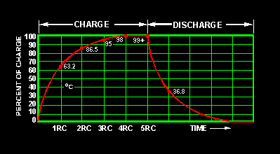

Think that formula needs a little work.
r/c
Works OK for me.
1 TC e^1 -- 63.2%
2 TC e^2 -- 86.5%
3 TC e^3 -- 95%
4 TC e^4 -- 98.2%
5 TC e^4 -- 99.3%
Your formula is missing an exponent. You couldn't get those values using it. The correct formula is:
Vn(tc)(%) = (1 - 1/e^n)X100%,
n = 1, 2, 3, 4, 5...
