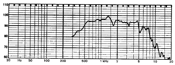

When I was doing PA systems, Altec Lansing horns had a very bumpy response and no high frequencies (above 5khz) that required a massive amount of equalization boost to be flat to only 10kHz with nothing in the highest octave. Here is a typical smoothed frequency response:
Use better quality horns then! :D
I would suggest those were purely for voice tannoy systems, and not general use.
