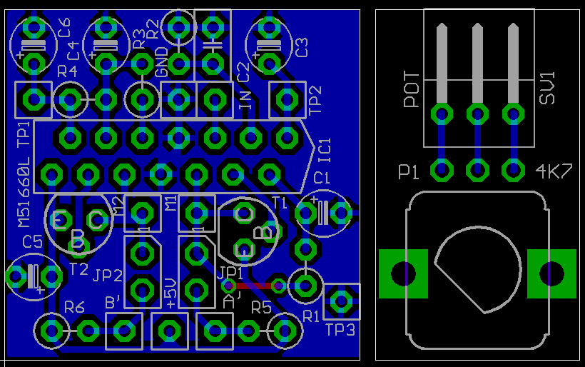

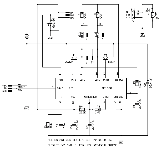

Hi ejector,
here is a servo controller with a small PCB. The dimensions are 25X25mm (1X1inch) with all parts to control a servo motor up to 500mA.
The chip used is a 14pin narrow package servo controller from Mitsubishi (M51660L).
For higher current servos (e.g. landing gear operation) use the on board transistors as drivers for the power transistors needed.
Here are the schematic and a PCB layout.

Thanks a lot for posting me the schmatic and Pcb. this is axectely what i was looking for.

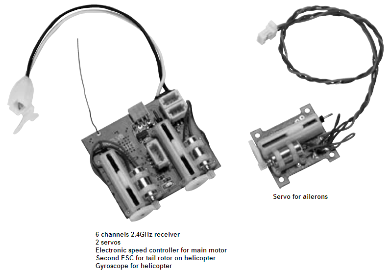

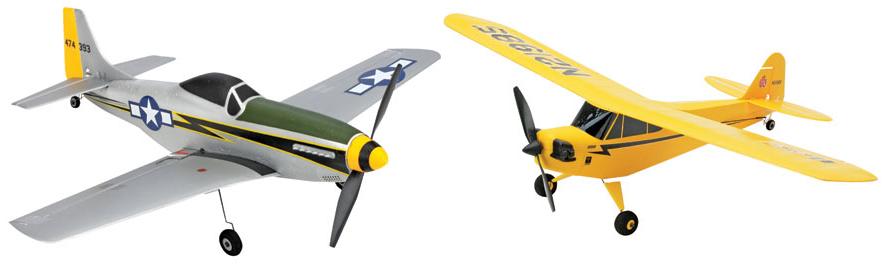

My small RC airplanes and helicopter have a 6-channels 2.4GHz receiver board that has 2 servos on it, two electronic speed controllers for the main motor and for the tail rotor and a gyroscope. The receiver board measures 1 square inch and weighs almost nothing. The servo board for the ailerons measures about 1/2 square inch and weighs almost nothing.
The Piper Cub airplane weighs almost nothing (29 grams with battery), the P-51 Mustang airplane weighs almost nothing (35 grams with battery) and the mSR helicopter weighs almost nothing (28 grams with battery).
The Li-Po single-cell batteries are 3.4 grams for 125mAh and 4.1 grams for 160mAh. Each airplane flight is 10 minutes to 15 minutes long and is 5 minutes for the helicopter.
The Piper Cub flies about 10kmh to 20kmh and the P-51 Mustang flies up to 30kmh. The P-51 Mustang has enough power to climb vertically.
