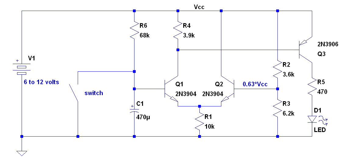

Mabauti's circuit will give you about 80 microamps through the LED, which I don't think will be visible in daylight. You might see it in a dark closet after your eyes get accustomed to the dark.:rolleyes:

Except that the transistor circuit doesn't have any of the features of the 555 timer except for the comparator. I got the impression that he might have transistors on hand, but no timers or comparators. The comparator (integrated or discrete) would also allow him to change the voltage divider and see what happens to the turn-on time. He could even use a pot (gasp)!:D

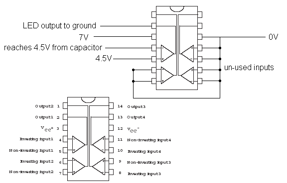

iv went over what you have said and come up with a schematic for my application, i have swapped the pins over so i dont have to use a pullup resistor, is this schematic correct???
i have not purchased the LM339 yet to test this as im not sure if this schematic is right?

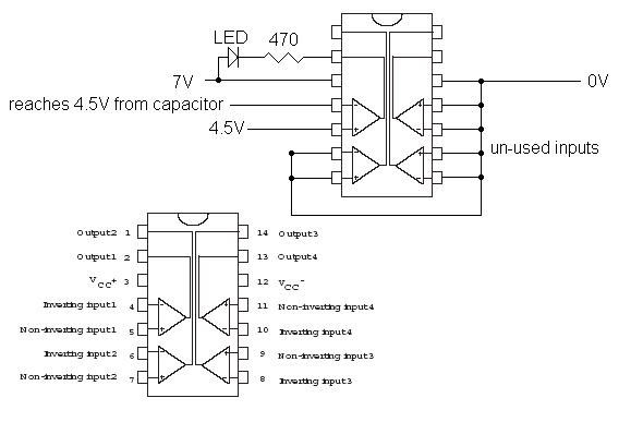

Looks good, except for the LED details. See below. You should also connect a 0.1uF ceramic capacitor from +V to ground to prevent oscillation. You can also use LM393, which is the same comparator, but there are only two of them, in a 8 pin package.

The output of the comparator will go from off Open circuit) to on (zero volts) when the cap voltage exceeds 4.5V, or whatever voltage you set the noninverting (+) input to. Look at it like this: When the - input is higher than the + input, the output will go low, and vice-versa.
Use a resistor divider to get 4.5V from 7V. The resistor to ground will have 4.5V across it, and the resistor to +7V will have (7 - 4.5) 2.5V across it. So, the resistors have to be in the ratio of 4.5 to 2.5, which equals 1.8 to 1. I would use 180k from the + input to ground, and 100k from the + input to +7V.
