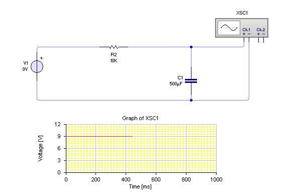

Teaching myself basic circuit theory with a few books and tutorials off the net etc
Question - With RC time constants if I want a time of 5 seconds with a 10K resistor using formula C=T/R gives me a capacitor value of 500microfarad. So does this mean that to reach 63% ish of my total value it would take 5 seconds using 10k and 500 microfarad?
Reason I am asking is that when using Livewire simulator with a 9V DC source and a scope connected across the capacitor, the value jumps straight to 9V across the capacitor. Is it not supposed to take around 5 seconds to reach 63% thus giving me a nice linear rise on the scope?
Graham
Yes, it should show that the cap reaches 63% of the supply voltage in 5 seconds, if the input impedance of the 'scope is very high.
Simulators screw-up if you don't enter all parameters correctly.
The voltage rising on a capacitor isn't "a nice linear rise", it is exponential. As the capacitor's voltage rises then its charging current decreases.
You will have a nice linear rise when you replace the resistor with a constant current source. :lol:
The circuit seems right. But it looks like the initial state of the capacitor is fullly charged. Check if there are any settings to set the initial voltage to zero. Otherwise, use a switch to discharge the capacitor, then start charging it up.

I have tried adding a switch to discharge the cap but when the switch is opened the voltage ramps back to 9v. As far as i am aware there are no options within Livewire simulator to start with fully discharged cap although I have not had probs with other basic cap circuits.

ok I tried again with the software, adding a switch works now, I have to start the circuit with the switch open then close it and hey presto.
