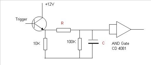

I need a circuit, when it get triggers it will turn the output after a delay.Delay determine by the values of R & C.
Is this circuit works?

Does the trigger stay high longer than the desired delay, or is it a momentary pulse?
Trigger comes from the door contact unit (dry output)
When the door open after the delay it will sound the buzzer.
But if the door open & close suddenly it won't sound the buzzer.
Is the door contact normally-closed (contact opens when door is opened)?

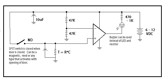

Here's a litlle circuit that might do the job.
It uses just about any comparator (LM324, 339, etc.) and any SPST switch that operates with the opening and closing of your door.
When the door is closed, the closed switch allows the capacitor in the positive input of the comparator to charge and hold. When the door is opened, voltage is cut off from the cap, and it begins to discharge. When the + input voltage falls below that of the - input, the comparator turns on and activates the buzzer.
The R*C combination can be adjusted to allow a desired delay time.
If the door is closed before the comparator is activated, voltage is reapplied to the cap and nothing happens.
The attached schematic is a bare bones idea to go by, if you are interested.
