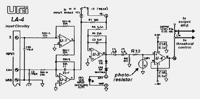

The RCA4136 is just about opposite to the industry standard LM324. V+ is pin 11, V- is pin 4. The other pins (in case you can't read the schematic) are:
-a in pin1
+a in pin2
a out pin3
+b in pin 5
-b in pin 6
b out pin 7
-c in pin 8
+c in pin 9
c out pin 10
-d in pin 14
+d in pin 13
d out pin 12
