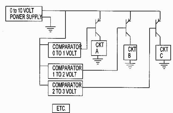

DEAR FRIENDS,
THANK YOU ALL FOR YOUR INTEREST AND CO-OPERATION LET ME REPLY YOUR QUERIES:
1. YES I HAVE ( MAX10 VOLT )VARIABLE VOLTAGE SUPPLY
2. MY PROBLEM IS:
- I HAVE SAME CONTROL VOLTAGE ( SAME TWO TERMINALS)
- I HAVE FIVE CIRCUITS TO CONTROL WITH SAME CONTROL VOLTAGE
- SUCH THAT IF CONTROL VOLTAGE IF ,IT ACTIVATES ONE CIRCUIT IF CONTROL VOLTAGE IS WITHIN (1V TO 2.5V). - AND IF CONTROL VOLTAGE IS MORE THAN 2.5 UP TO 3.5 IT ACTIVATES SECOND CIRCUIT AND SO ON.
- BUT IF FIRST CKT (1V TO 2.5V) SHOULD NOT GET ON IF IT WERE OFF WHEN CONTROL VOLTAGE IS MORE THAN 2.5V AND SHOULD NOT GET OFF IF IT WERE ON PREVIOUSLY. ALSO I MEAN IT MUST NOT HAVE SELECTIVITY OF ON OR OFF IF CONTROL VOLTAGE IS NOT WITHIN RANGE (1V TO 2.5V) SAME FOR OTHER CKTS.
I THINK MOST QUERIES ARE CLEARED
THAKING U
HEMANG

sound like you need a comparator cct to do this

This is generally how to do it, I don't have time to work out the details:

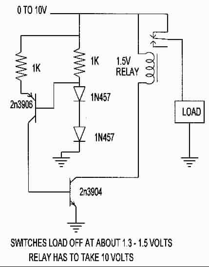

thank u Mr.Russlk, for the diagram can i know now that how a simple comparator can handle a range say from 1v to 1.5v? or the two opamp comparators with AND gate is needed?
thnx in advance
hemang
Making the circuit work at 1.5 volts is a challange, but this should work:
The relay may be a custom design, I don't know of a 1.5V relay that will stand 10 volts. The other compartors are window type, you can look it up or, I think an IC is available. Look for "window comparator".
