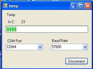

I figure some one could use this it's in swordfish basic it reads the adc value and sends it
to A VB program that shows the temperature Celsius
The function you'll need to change 4300 to match your adc VREF+ if using Vdd take a reading and plug that in
Like say you get 4.99 volts you'll change 4300 to 4990

And a look at plus the whole VB program

It's visual basic 2008 express I haven't used it much just vb6 a Jalv2 friend gave me and example of how to use serial coms and I remade the program with it. Here the whole thing.

As you are using a CDC I presume it would just come up as a COM port?

Back to the LM35 and usb It's using usb to make a com port here the hex
