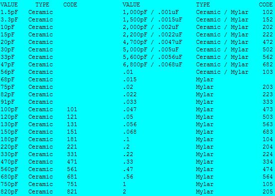

I can never really remember the conversions, so I just use this pic to figure it out...

And as per jrz126's image there is nothing for capacitors of 0.22 pF.... I remember seeing it in the shop. Or am I mistaken?

All those values are pretty obvious, and you don't get 0.22pF capacitors, it's really too low.
