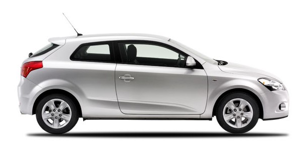

It makes me laugh when the Americans talk about economy.
Over there, hitting 20mpg seems an achievement. Over here anything above 50mpg is considered economical.
We are currently driving a car with a 2.0 Litre engine, 140bhp, 305nM Torque (225lb/ft) and a top speed of 127MPH. It can do 0-60 in around 10 seconds which isn't fantastic but .......
It can easily get 63 miles to the gallon.
Attached is a picture - can anyone guess what it is ?
Ford Focus?

Ford Focus?
Nope - guess again.
You might be rather suprised.
